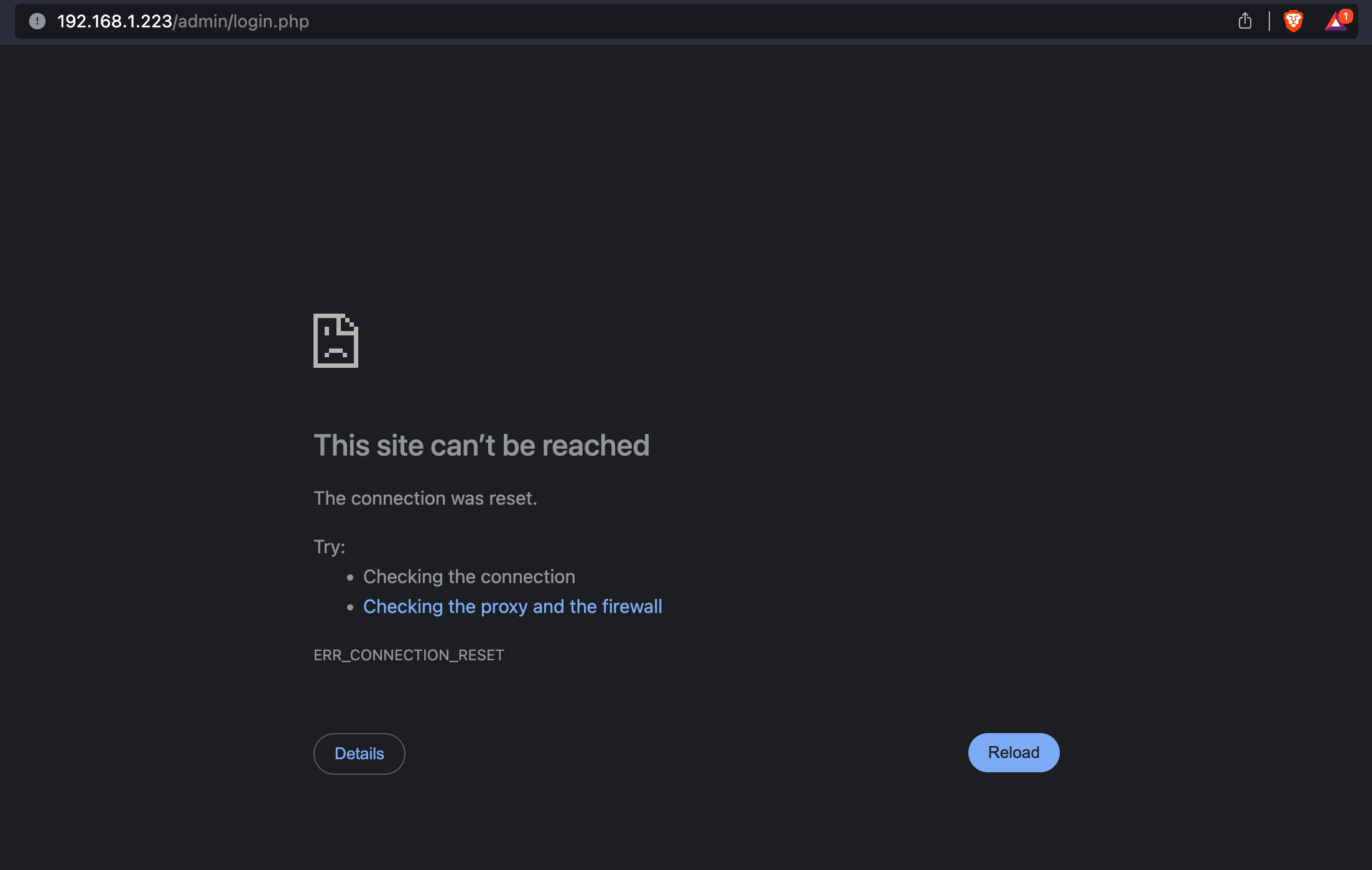

Thank you for your help. I've tried http://192.168.1.223/admin/login.php from all my devices, wired and wireless, mobile and desktop, different browsers (safari/brave with and without shields) and they all spin for about 5 minutes then I just get the standard timeout message. I've opened all ports as per documentation on the device itself and I'm able to telnet to port 80.
I've used piholes for years and I currently have two others that are working flawlessly, same config. The only difference between those and this one is that the working piholes are hosted on PVE while the problematic pihole is running off a VM hosted on Unraid. I've never had this issue before and thus I remain flummoxed.
Interesting note is that if I misspell the URL I'll get an immediate 404 such as:
http://192.168.1.223/admin/lgin.php

Interesting. I do not. On the working piholes I am able to see the expected results but not on the .223 device:
curl http://192.168.1.223/admin/login.php
curl: (56) Recv failure: Connection reset by peer

I turned off potential rules for this ip address at my firewall, essentially DMZ'ing it and still no dice. I compared the firewall entry for all the piholes and they are identical in terms of settings. Unraid doesn't have a built-in firewall and there are no firewall settings for the actual VM itself.
Just for fun I spun up a new Ubuntu 22 VM on a different IP (.224), updated it, installed pihole, and same results. It's gotta be something on my network. Just baffling me because SSH works, and all tests to port 80 work.
