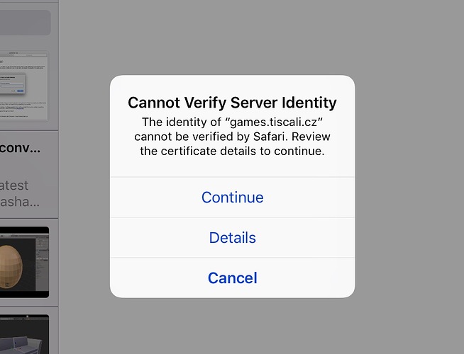

"Cannot verify server identity" Synology
When Pi-hole is active, I'm getting this from Safari like ten times an hour. What can I do? Thanks.
EDIT: many different pages do this, it's not limited to games.tiscali.cz.

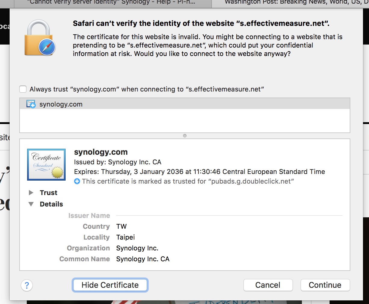

New example, with VPN disabled. The site visited is washingtonpost.com

Your configuration is trying to redirect an https connection, normally this would hit the Pi-hole and be blocked, but your Synology is running on port 443 and trying to respond with its own certificate. The warning are valid as your browser is interpreting this as an attempt at a Man In the Middle attack.
