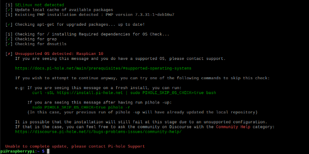

Cannot update Pi-Hole - Error: Unsupported OS Detected: Rasbian 10
Error: Unsupported OS Detected: Raspbian 10

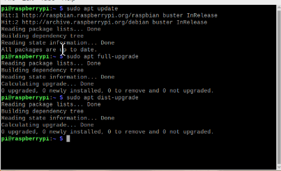

I've run full-upgrade on the OS. All OS updates have been successfully installed.

Try this:
sudo apt update
sudo apt full-upgrade
sudo apt dist-upgrade
sudo reboot
This is correct, but you still have an old OS.
Raspbian 10 / Debian 10 (also called "Buster") is no longer supported by either Debian or Pi-hole.
You have 2 options:
  1. backup your Pi-hole settings (teleporter), install a new OS, install Pi-hole and than restore Pi-hole settings.
  2. use the PIHOLE_SKIP_OS_CHECK variable, like suggested in the error message:
    If you are seeing this message after having run pihole -up:
         sudo PIHOLE_SKIP_OS_CHECK=true pihole -r
    (In this case, your previous run of pihole -up will have already updated the local repository)

Thanks for the input. I tried that - same results:
I rebooted and am still getting the same error when running pihole -up:
Try this command:
