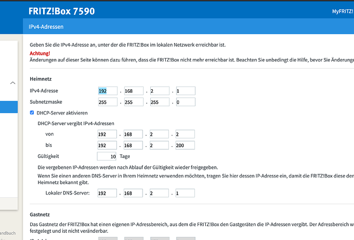

Where on the router did you change DNS (paste screenshot) ?
Below the proper way using DHCP:
I put it in DNS server sheet in the internet access register from my Fritzbox.
That way the clients will query the router first for DNS.
The router forwards the DNS query to Pi-hole that will forwards queries to upstream configured DNS servers.
This way all queries seem to appear coming from the router.
So you wont see individual stats on the Pi-hole web GUI.
Try search here on discourse how folks configure their FritzBox to push the Pi-hole IP address as a DNS server to the clients using DHCP.

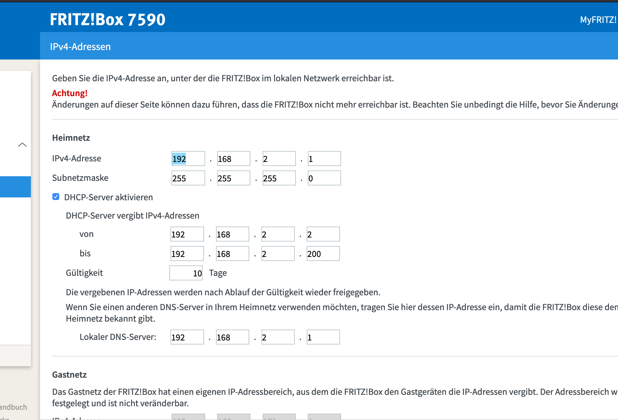

I found another way(a bit hidden) how to manage ipv4 addresses....
It says local DNS server...
I put in the Pihole ip....
That looks better.
