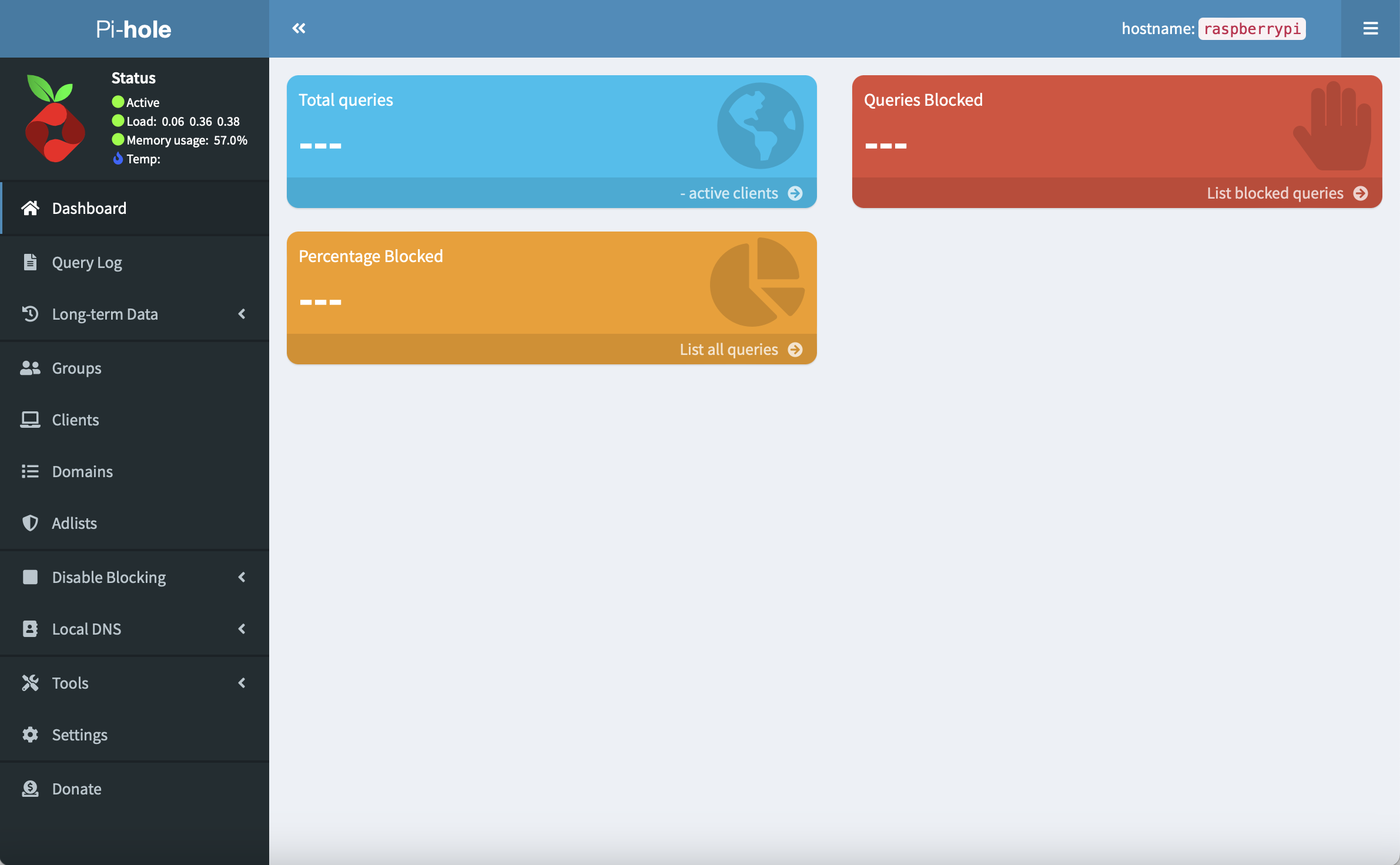

The issue I am facing:
When trying to load the long term data I get the following error:
An unknown error occurred while loading the data.
Check the server's log files (/var/log/lighttpd/error-pihole.log) for details.
You may need to increase PHP memory limit.
You can find more info in pi-hole's FAQ:
FAQ - Pi-hole documentation
Also the Web UI is bugged (see screenshot attached): it does not show all data such as temperature, it does not show the page's footer in the homepage (it does in other pages), and it does not show any of the blocked data.
PiHole is correctly blocking ads.

Looks like your PHP installation is missing a module (not installed or disabled):
2023-12-19 14:40:54: mod_fastcgi.c.487) FastCGI-stderr:PHP Warning:  Use of undefined constant SQLITE3_OPEN_READONLY - assumed 'SQLITE3_OPEN_READONLY' (this will throw an Error in a future version of PHP) in /var/www/html/admin/scripts/pi-hole/php/database.php on line 57
2023-12-19 14:40:54: mod_fastcgi.c.487) FastCGI-stderr:PHP Fatal error:  Uncaught Error: Class 'SQLite3' not found in /var/www/html/admin/scripts/pi-hole/php/database.php:42
Try to install the module using this command:
sudo apt install php-sqlite3
