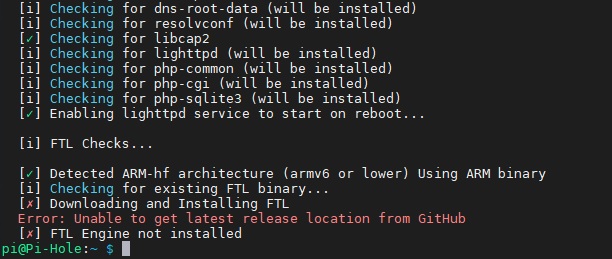

[✓] Detected ARM-hf architecture (armv6 or lower) Using ARM binary
[✗] Downloading and Installing FTL
Error: Unable to get latest release location from GitHub
[✗] FTL Engine not installed
pi@Pi-Hole:~ $ pihole
-bash: pihole: command not found
pi@Pi-Hole:~ $
and the pihole command still doesn't work.

+ local directory=/etc/.pihole
+ local remoteRepo=https://github.com/pi-hole/pi-hole.git
+ local 'str=Check for existing repository in /etc/.pihole'
+ printf '  %b %s...' '[i]' 'Check for existing repository in /etc/.pihole'
  [i] Check for existing repository in /etc/.pihole...+ is_repo /etc/.pihole
+ local curdir
+ local rc
+ curdir=/home/pi
+ [[ -d /etc/.pihole ]]
+ cd /etc/.pihole
+ git status --short
+ cd /home/pi
+ return 0
+ printf '%b  %b %s\n' '\r\033[K' '[\e[1;32m✓\e[0m]' 'Check for existing repository in /etc/.pihole'
  [✓] Check for existing repository in /etc/.pihole
+ update_repo /etc/.pihole
+ local curdir
+ local 'str=Update repo in /etc/.pihole'
+ curdir=/home/pi
+ cd /etc/.pihole
+ printf '  %b %s...' '[i]' 'Update repo in /etc/.pihole'
  [i] Update repo in /etc/.pihole...+ git stash --all --quiet
+ git clean --quiet --force -d
+ git pull --quiet
+ return 1
+ printf '\n  %b: Could not update local repository. Contact support.%b\n' '\e[1;31m' '\e[0m'
+ exit 1
pi@Pi-Hole:~ $

@DanSchaper Here you go !
pi@Pi-Hole:~ $ cd /etc/.pihole
pi@Pi-Hole:/etc/.pihole $ sudo git clean
fatal: clean.requireForce defaults to true and neither -i, -n, nor -f given; refusing to clean
pi@Pi-Hole:/etc/.pihole $ sudo git pull
fatal: unable to access 'https://github.com/pi-hole/pi-hole.git/': Could not resolve host: github.com
