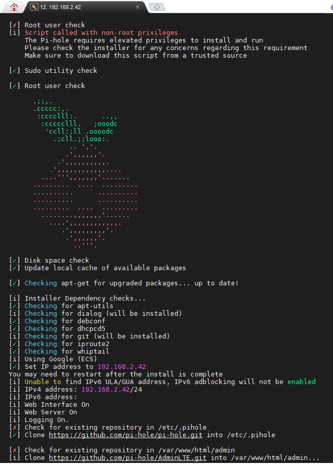

Now, pihole command doesnt work. so here a screenshot and the log i seen on where it crash.
[āœ—] Root user check
  [i] Script called with non-root privileges
      The Pi-hole requires elevated privileges to install and run
      Please check the installer for any concerns regarding this requirement
      Make sure to download this script from a trusted source
  [āœ“] Sudo utility check
  [āœ“] Root user check
        .ccccc:,.
         :cccclll:.      ..,,
          :ccccclll.   ;ooodc
           'ccll:;ll .oooodc
             .;cll.;;looo:.
  [āœ“] Disk space check
  [āœ“] Update local cache of available packages
  [āœ“] Checking apt-get for upgraded packages... up to date!
  [i] Installer Dependency checks...
  [āœ“] Checking for apt-utils
  [i] Checking for dialog (will be installed)
  [āœ“] Checking for debconf
  [āœ“] Checking for dhcpcd5
  [i] Checking for git (will be installed)
  [āœ“] Checking for iproute2
  [āœ“] Checking for whiptail
  [i] Using Google (ECS)
  [āœ“] Set IP address to 192.168.2.42
  You may need to restart after the install is complete
  [i] Unable to find IPv6 ULA/GUA address, IPv6 adblocking will not be enabled
  [i] IPv4 address: 192.168.2.42/24
  [i] IPv6 address:
  [i] Web Interface On
  [i] Web Server On
  [i] Logging On.
  [āœ—] Check for existing repository in /etc/.pihole
  [āœ“] Clone https://github.com/pi-hole/pi-hole.git into /etc/.pihole
  [āœ—] Check for existing repository in /var/www/html/admin
  [i] Clone https://github.com/pi-hole/AdminLTE.git into /var/www/html/admin...
  Error: Could not update local repository. Contact support.
pi@Pi-Hole:~ $ pihole
-bash: pihole: command not found
pi@Pi-Hole:~ $
