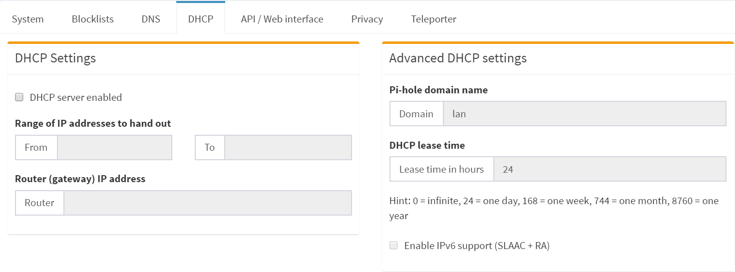

DHCP should actually disable when I disable it in the GUI and in the config file, and using a docker environment variable.
GUI:
