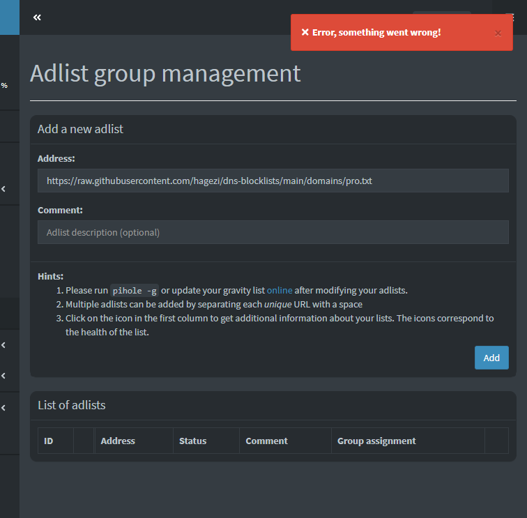

Screenshot when trying to add this one:
https://raw.githubusercontent.com/hagezi/dns-blocklists/main/domains/pro.txt
Your debug log shows your lighttpd (the web server) installation seems incomplete.
*** [ DIAGNOSING ]: contents of /etc/lighttpd/conf-enabled
total 0
lrwxrwxrwx 1 root root 33 Jan  1 03:58 10-fastcgi.conf -> ../conf-available/10-fastcgi.conf
lrwxrwxrwx 1 root root 37 Jan  1 03:58 15-fastcgi-php.conf -> ../conf-available/15-fastcgi-php.conf
lrwxrwxrwx 1 root root 42 Nov 19 13:35 90-javascript-alias.conf -> ../conf-available/90-javascript-alias.conf
Usually there are at least 3 more files there: 05-setenv.conf, 10-accesslog.conf and 15-pihole-admin.conf (the main Pi-hole Dashboard config file).
Can you try to reconfigure Pi-hole running pihole -r and selecting "reconfigure"?

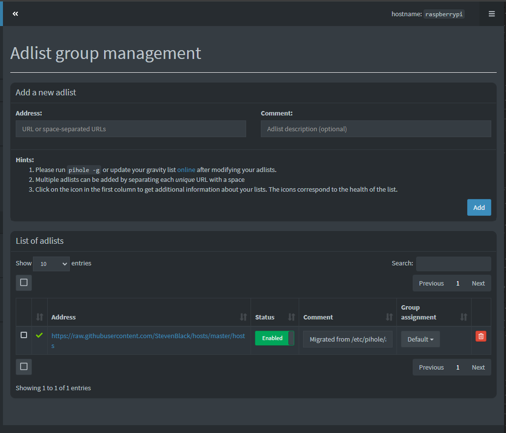

That worked like a charm! The Dashboard is now displaying stats and lit up like a Christmas tree. The adlist now displays the list included with Pi-hole, and I'm able to add another list.
Thanks, so much. Happy New Year!
