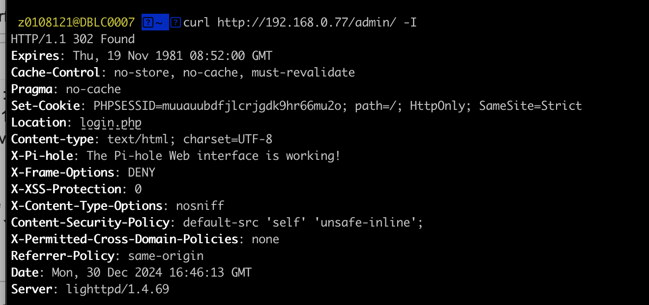

After running through the installation I'm not able to access the web interface on <STATIC_IP>/admin or pi.hole/admin. From my local machine, I'm able to curl it
However, from my browser (Chrome) I'm not able to access it. I'm getting an ERR_ADDRESS_UNREACHABLE error.

As you noticed, the web interface is running and it is working, but for some reason Chrome is not able to reach the IP.
Is the "local machine" the same machine where Chrome is installed?
If it is, Chrome is probably using a different DNS server (try to disable "Secure DNS" or something similar in Chrome settings).

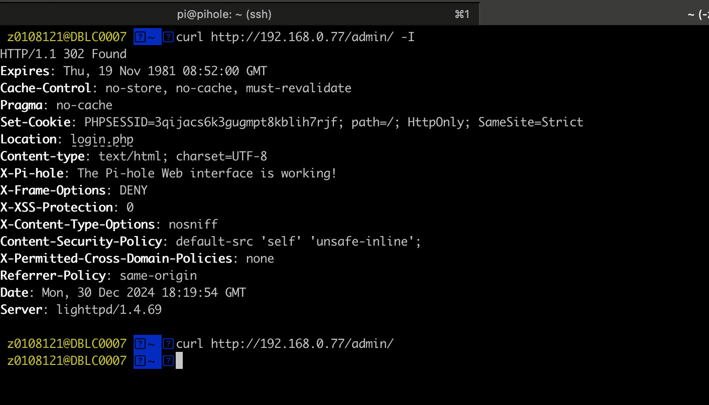

I get a 302 from my Terminal but no content when I take out the -I flag
I turned off SecureDNS from my Chrome settings and tried different browsers and incognito mode, but it's still not showing up
This is normal and it shows the web interface is working.
I see the same here without the flag.
To see the page content try to use the full URL:
curl http://192.168.0.77/admin/login.php
(it should return the HTML/PHP code)
