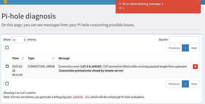

Now I habe a diagnosis message (the unbound related) here is a screen shot and tricorder upload. Thank you!
https://tricorder.pi-hole.net/x51gJvk1/
