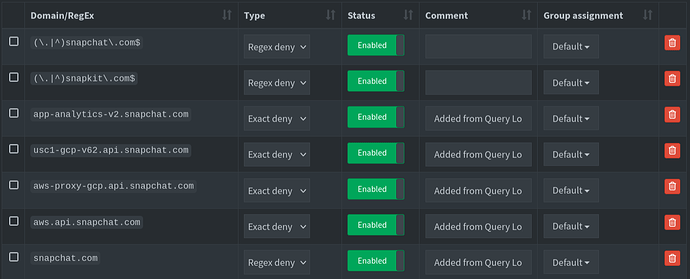

sudo pihole -d
Here's the log:
cat /var/log/pihole/pihole_debug.log | grep "snap"
220 regex-deny yes 0 (\.|^)snapchat\.com$ 2025-08-31 22:51:21 2025-08-31 22:51:21
270 regex-deny yes 0 (\.|^)snapkit\.com$ 2026-03-27 19:13:04 2026-03-27 19:13:04
286 exact-deny yes 0 app-analytics-v2.snapchat.com 2026-05-13 20:41:04 2026-05-13 20:41:04 Added from Query Log
288 exact-deny yes 0 usc1-gcp-v62.api.snapchat.com 2026-05-13 20:41:20 2026-05-13 20:41:20 Added from Query Log
289 exact-deny yes 0 aws-proxy-gcp.api.snapchat.com 2026-05-13 20:41:29 2026-05-13 20:41:29 Added from Query Log
290 exact-deny yes 0 aws.api.snapchat.com 2026-05-13 20:41:35 2026-05-13 20:41:35 Added from Query Log
291 regex-deny yes 0 snapchat.com 2026-05-13 20:58:24 2026-05-14 15:01:24 Added from Query Log
124 yes 0 Block https://raw.githubusercontent.com/mrxehmad/pi-hole-adlist/refs/heads/main/snapchat-pihole 2026-05-14 15:11:53 2026-05-14 15:11:53

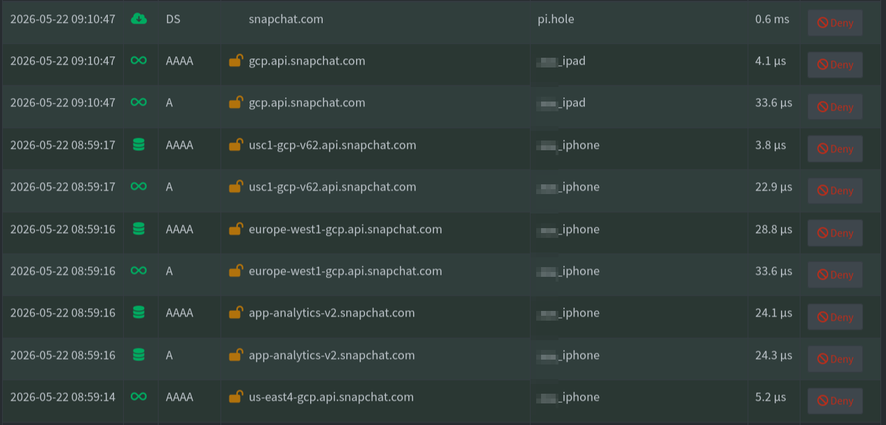

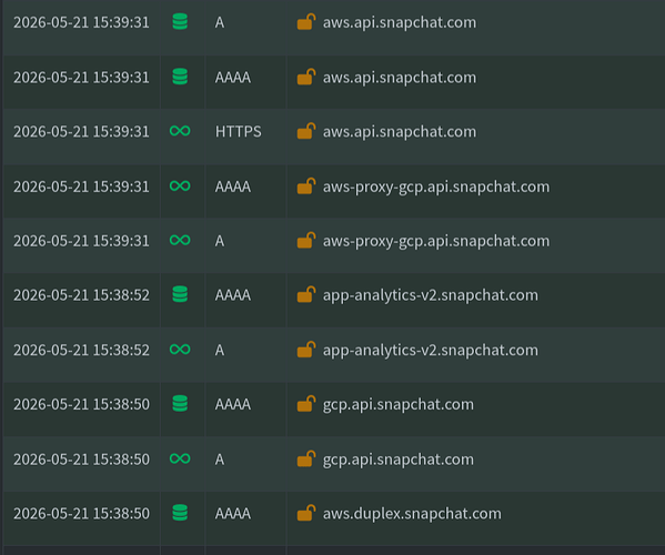

but:
Please execute sudo pihole -d, upload the log when asked and then post here the token.
Here is the token:
https://tricorder.pi-hole.net/wms6jvkz/
