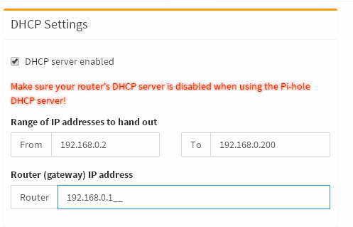

after you installed, did you enable the DHCP server from the pi-hole interface?
You could install the Pi-hole first, (that takes care of all the dnsmasq related steps from that guide, as long as you configure it as your DHCP server from the admin interface) and then follow the hostapd steps.
Doh, I totally didn't, thought it was already, though now that I use a
few more braincells I see why it wouldn't be. :slight_smile: Doing too many things
at once here.
Yup, that did it. Then I was assigned an IP but DNS didn't work from
clients. Had to switch from all interfaces/one hop to wlan0. Now things
are working fine.
Thanks for the prompt help!
