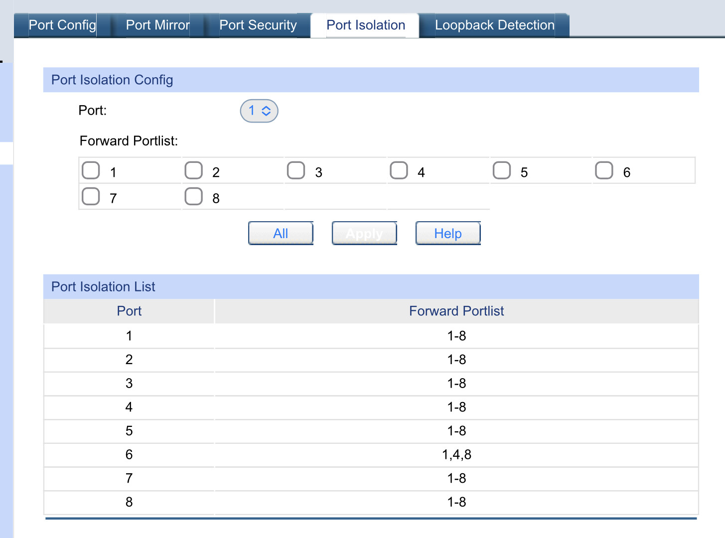

I do it on a hardware level with a managed switch via port isolation. The Access Point on port 6 is only forwarded to port 1 (the router), port 4 (the pihole acting as DHCP and DNS server) and port 8 a security device (Fingbox). This AP runs the guest network so anyone connected to it can’t reach other servers or devices which are connected to other ports of the switch.
Wonderful - this seems to be the solution, and I am very grateful for your kind help! :smiley:

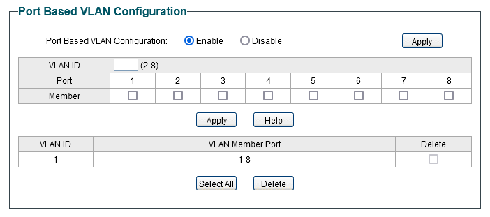

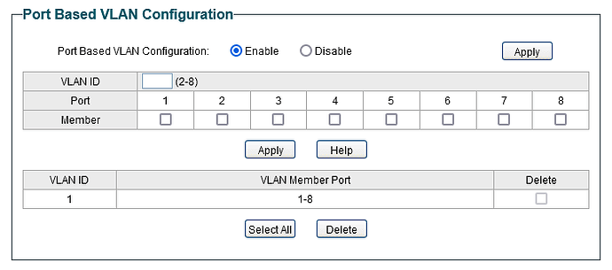

I've a similar menu on my managed switch and assume that the below menu is the right one I have to set up properly (currently, there is no restriction):
This is called "port-based VLAN", and there are some other options, too, but I think that I don't need any of those, right?
Hi there, VLAN is something else. You can sub-segment a physical network into virtual segments, i.e. you can have 192.168.1.x and 192.168.2.x sub-nets and have different devices on different sub-nets. You can arrange these devices may or may not communicate each other via VLAN settings on your managed switch. What I was saying was something else, port isolation is switching on or off which ports will be connected to which ports - like a telephony operator. For your purpose, you can use either port isolation or design virtual lans in your network, both will work your purpose.
