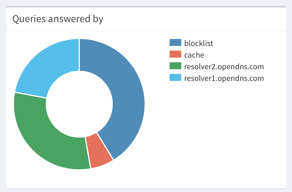

which of these statistics would you like to see? Something like queries forwarded 46, queries answered locally 22 could always be reported by FTL without having to have dnsmasq report anything. I doubt that it is important how many domains are currently in dnsmasq's cache, as only the result (ration forwarded/cached) is of interest. This information is already made available in the Forward Destinations (integrated) graph (see local).

Implemented in v4.0
$ echo ">forward-dest" | nc 127.0.0.1 4711
-2 44.27 blocklist blocklist
-1 11.61 cache cache
0 24.40 208.67.220.220 resolver2.opendns.com
1 19.73 208.67.222.222 resolver1.opendns.com
