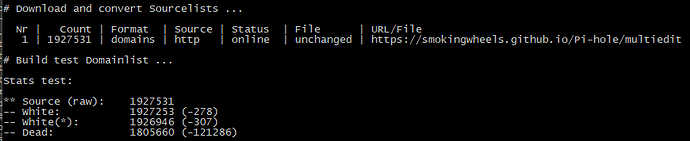

Blocklist approx 1.9 million domains includes my allhosts and @hagezi multi blocklist
My piholes where getting very slow on the domain page with over 900 on the list so I fixed it.
I have been using the @hagezi multi list as well for some time now.
I wrote a program in QB64 to process my lists so I can whitelist sites when my domain list grows too much.
https://smokingwheels.github.io/Pi-hole/multiedit
see screen dump

I checked your generated multiedit list against my whitelist of falsely blocked domains (without using referral domains whitelist) and for dead domains, here is the result:
585 false positive domains
121286 dead domains
1805660 domains after cleanup
in your list e.g. the following domains are blocked:
