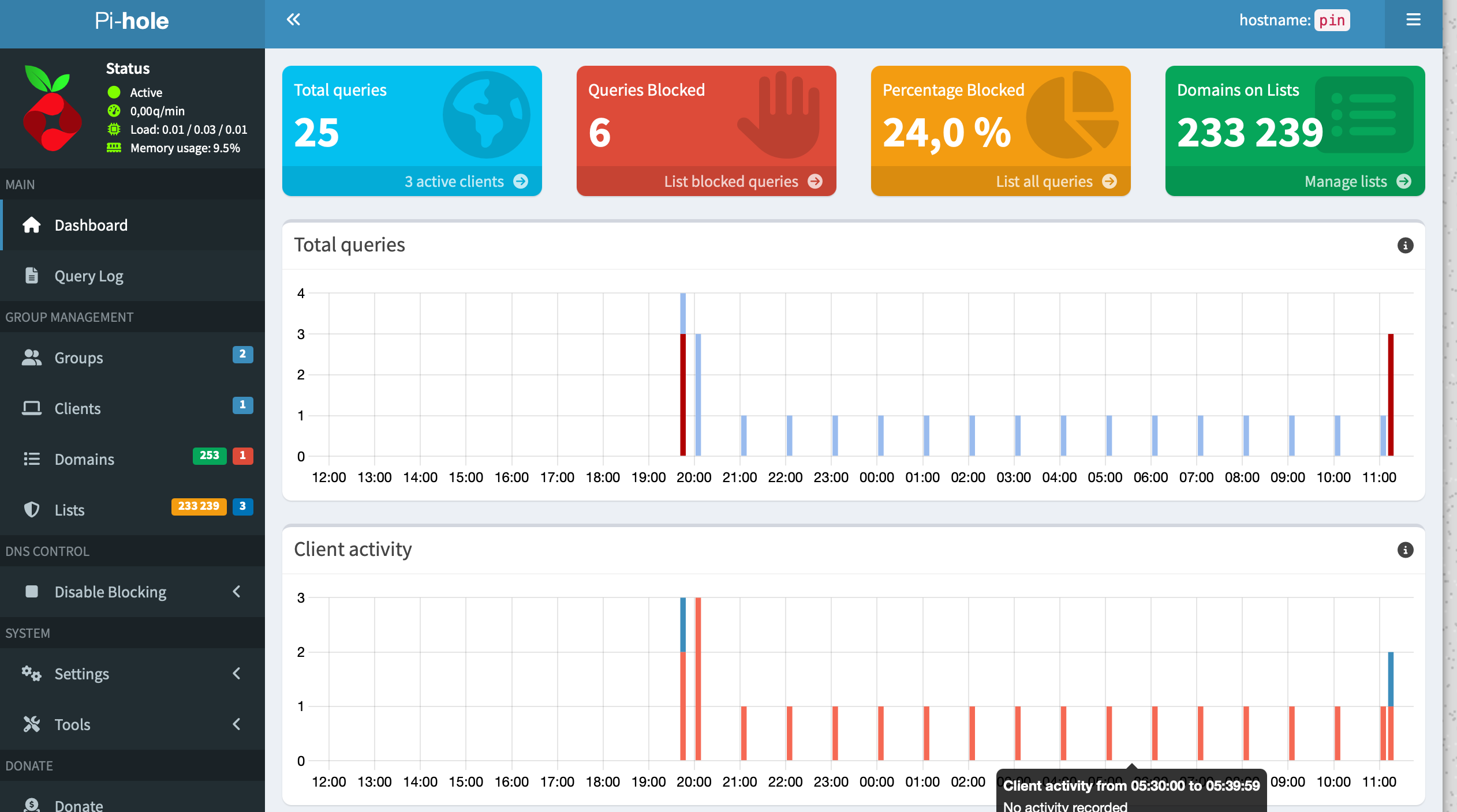

The problem (from before I installed the proxy server) is that queries don't seem to be recorded in the DB. The reason I say so is that when I click the query log from the web interface I just see hourly '1.0.0.127.in-addr.arpa' requests.
Also the dashboard doesn't show any clients query (although some clients are accessing it).

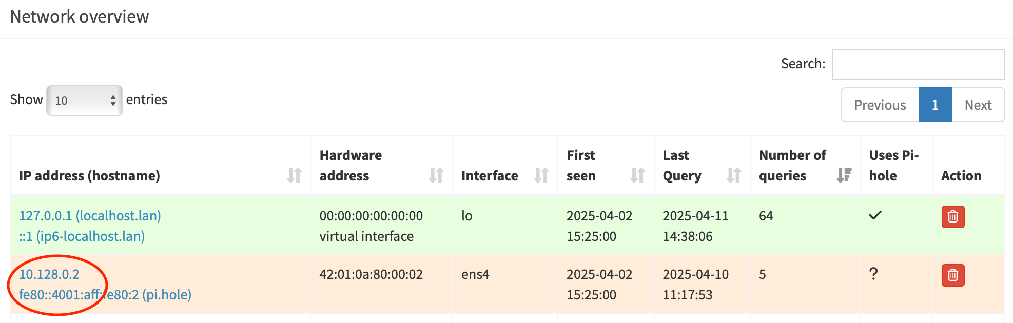

A sql query to the database shows almost only PTR requests, see below. There are very few exceptions. all IPv6 like the one from px.za.zaloapp.com below. Even when I query the db, just after accessing a new site (to exclude caches) from my browser, nothing appears in the db:
