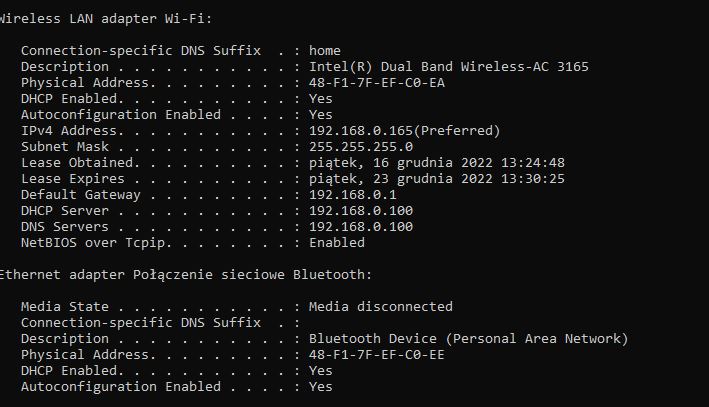

In Windows 10, the ipconfig /all command shows Pihole as DNS

Here is ipconfig:
