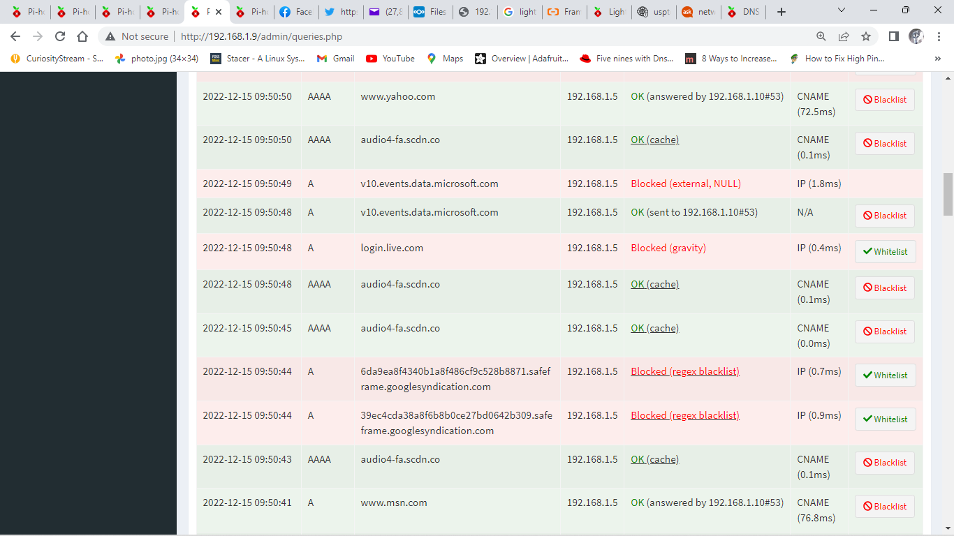

The issues I am facing:
The DNS request bypasses the pihole and it sends the request to the upstream server.
The DNS request on the pihole won't cache, thus sending it upstream to next pihole and it does the same thing at random times.
The DNS request on the pihole sends the request upstream even though its cached.
The DNS request bypasses the pihole quire log info page in admin.

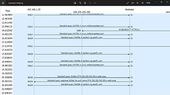

The Spotify client has been sending extra Valid DNS requests to spclient.wg.spotify.com but its triggered on the back of many other microsoft DNS requests. Hence the hosts file.
I found a handy DNS program which I have been using to troubleshooting the windows > pihole setup.
Nirsost DNSSniffer
I had wireshark running as well and got a diagraph of what goes on with spotify.
I have a 4 GB packet log over 2 days with ads on spotify. My PC is too old to do much with it.
I had bat file with 6 Nslookup's running in an endless loop to test the speed of DNS in windows and check for timeouts.
With the help of Dnssniffer I was able to see the requests, some go unanswered. You could also see the triggered requests.
I ended up adding each domain as it came along.

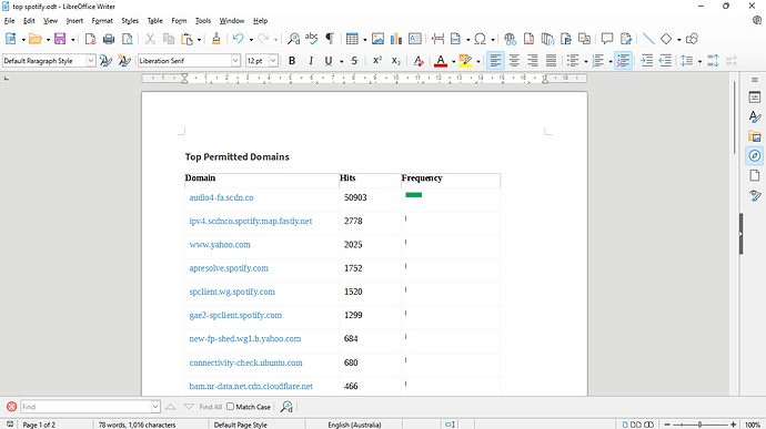

This was the stats yesterday after My Nslookup loop running for a few hours.
It cycled approx 2000 times according to yahoo lookups and there was the spotify clent domain with 50000 hits.
I now have no adds on spotify in windows and linux. Have Android to test later.
Nslookup work better not so many timeouts.
