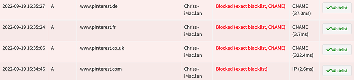

Any non-www is resolved and rewritten to www at their end, and the various TLDs are CNAMEs for .com, so the rule always kicks in. Sample below

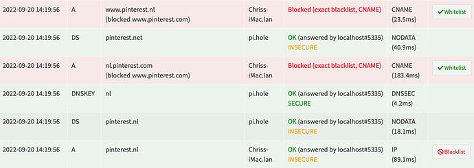

I just noticed that pinterest not only uses 'pinterest.nl', but also 'nl.pinterest.com' That too should be blocked now if I did everything right.

Same here @Plef, that was why I had a few TLDs previously configured. After your post I tested it yesterday and found that they were all blocked by that regex even though the TLDs were not explicitly configured. That's when it became apparent that they bounce non-www to www and use CNAMEs for all. So I binned the old rule and just have this now.
I just tested nl and sure enough it's similarly blocked. Interestingly, since the update yesterday, the Query Log now shows the actual domain blocked, eg "(blocked www.pinterest.com)" via the CNAME, which is handy.
