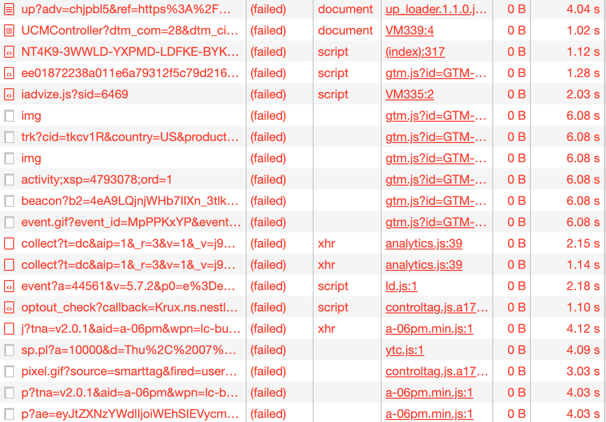

Requests to blocked domains visible in Chrome Developer tools take up to 30 seconds to timeout

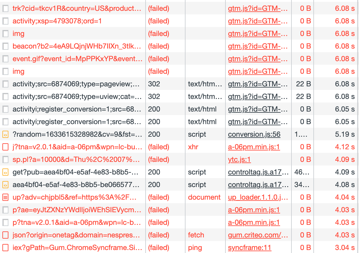

Could you perhaps share a screenshot of the delay as shown by your Chrome developer tools? In this forum, you are able to paste images directly.
Thank you for your time and help, my thread title is a bit misleading as those were the symptoms before I cleaned out a few very old ad lists right before this post and I didn't give it enough time to notice while there still is kind of a hang effect in the browser as these scripts attempt to load but it is now reduced quite a bit. Probably something I need to figure out on my machine testing different browsers. Thanks for your time
