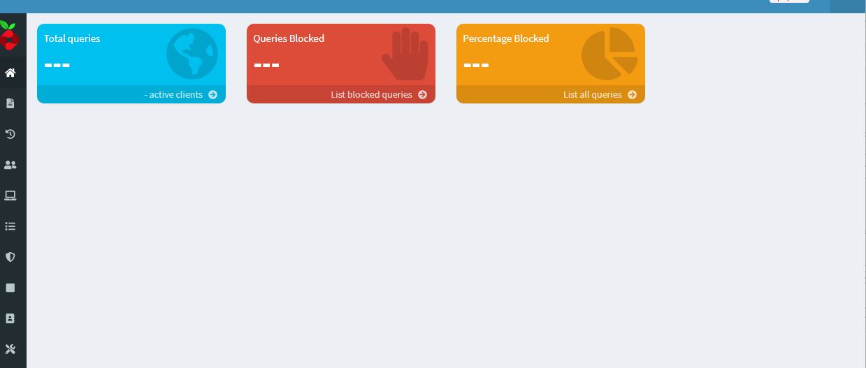

Seeing a blank dashboard after upgrading to v5.18.4, other menu items are working. Running on Raspberry Pi 4, bookworm 64-bit. Diagnosis reports "No issues found."

Please see attached screen shot of Dashboard.
I haven’t used chrome in a while, but if you can see the debug console, and see no errors, that is something.

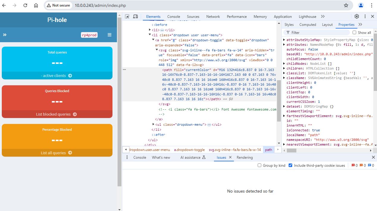

Just in case we missed something, please open the Chrome console using this key combination: Ctrl + Shift + J
Here are the steps used:
  1. Launch Chrome
  2. Ctrl + Shift + J
  3. Navigate to Pi-hole web http://10.0.0.243/admin
  4. Enter password
  5. Click "Log in" button
See attached screen shot, no issues detected.
Are there error messages in the "Console" tab?
If there are no errors, please generate a new debug log. The previous one expired.
There are no errors in the console tab.
