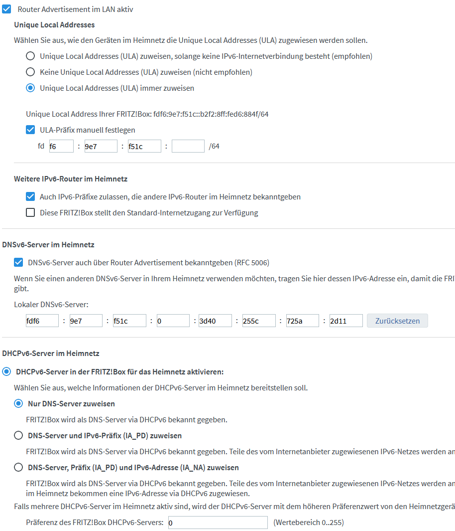

This client is not using Pi-hole but your Fritzbox via IPv6 as DNS server. Read about FB IPv6 configuration here:
Thanks a lot, I really appreciate that.

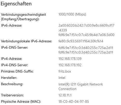

I changed the settings for the ipv6 as dokumented. As you can see, my PC (Client) has no the ipv6 and ipv4 from the pi-hole:
As far as I can see this is the same ipv6 adress. I copied that from pi-hole.
pi@raspberrypi:~ $ ip address | grep "inet6 fd"
    inet6 fdf6:9e7:f51c:0:3d40:255c:725a:2d11/64 scope global dynamic mngtmpaddr noprefixroute
And my fritz.box configuration:

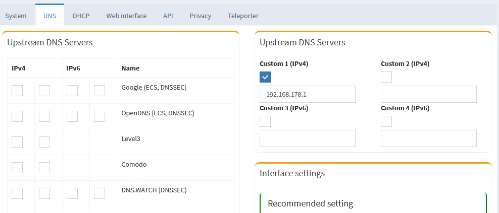

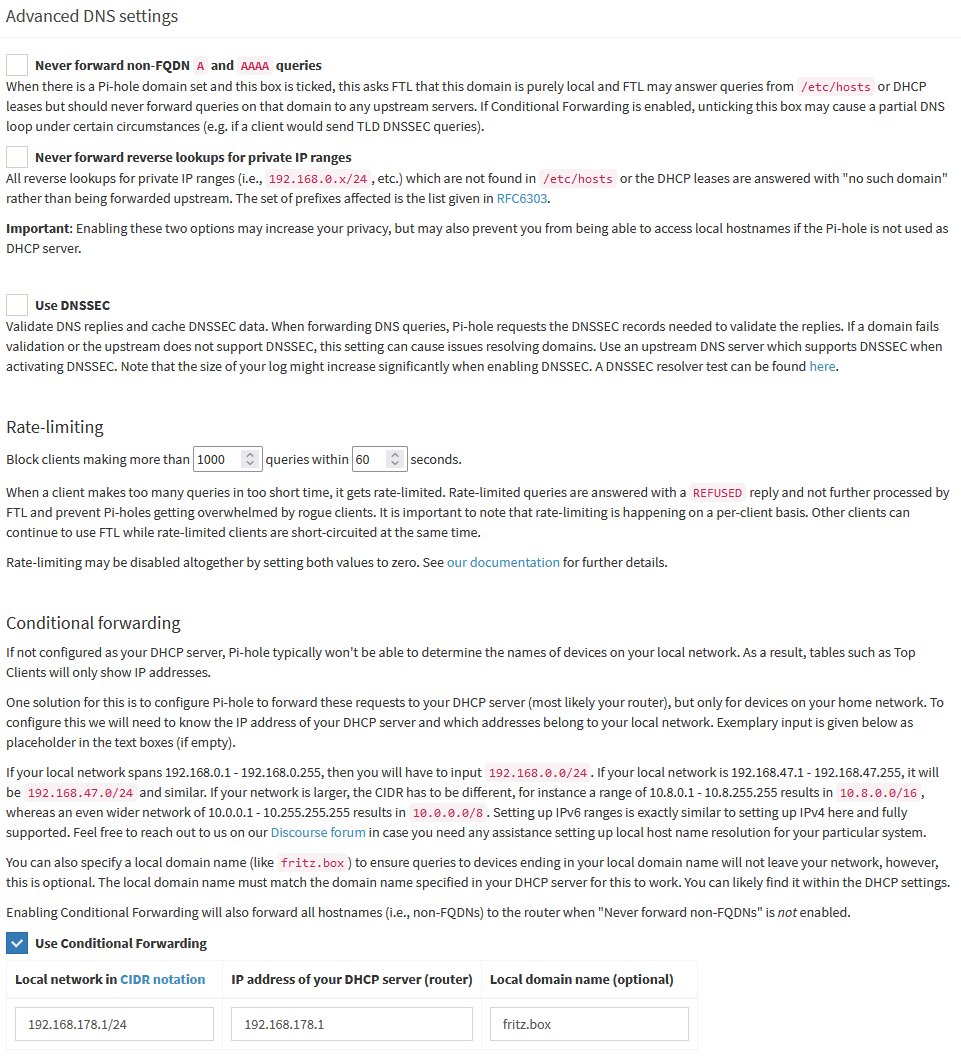

I asked uncle google, changed setting in pi-hole like:
And:
But if I add the url "stats.wp.com", it is listed in pi-hole but obviously not blocked ...
