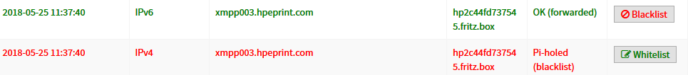

Blacklisted Domain only blocked via IPv4
thats seems like the Client could reach the Site via IPv6 anyway, blacklisting the IPv6 entry wont work either...

i created the pihole-ftl.conf with that entry, the remaining entries are false positives? i dont really understand the following steps...

Your Pi-hole (and network) does not have ULA addresses. It is not set up for IPv6 communication. The entries are false positives as they are for AAAA records that only will be accessible via IPv6. So the steps in the linked FAQ are for not displaying the AAAA record queries since they are not applicable to your network.

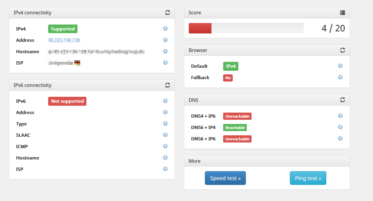

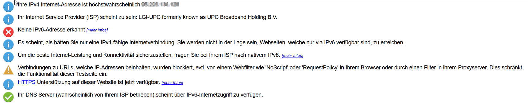

opened that site manually, heres the Result:

Not sure, something happened with them. You can try http://test-ipv6.com/ in it's place, but it is showing that your clients do not have IPv6 support.
