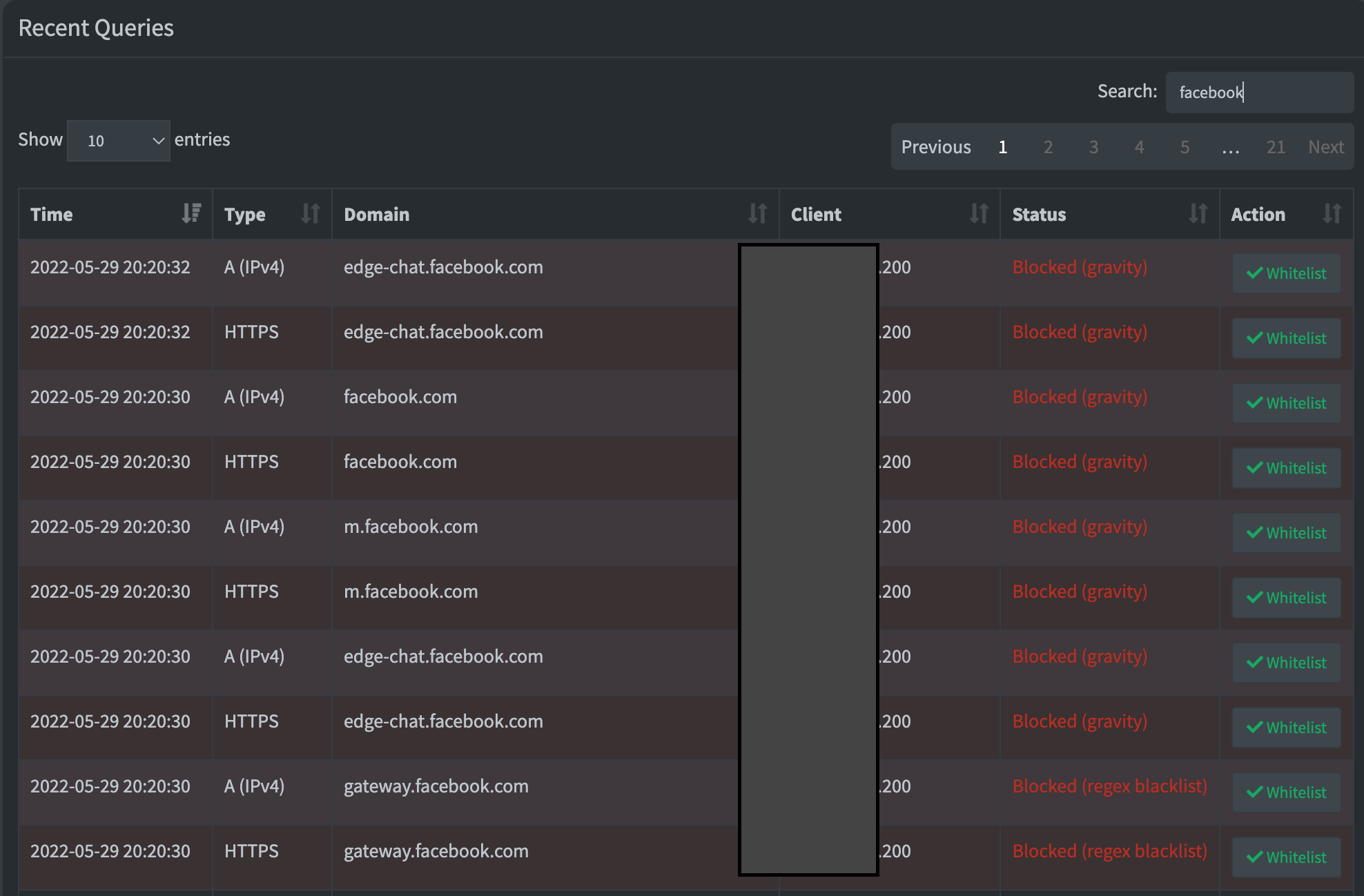

Opening Facebook/Instagram on devices in a specific group (jen) should work.
Queries to FB/IG domains are blocked.
https://tricorder.pi-hole.net/1rvc9x6W/
The specific device (iphone) in question has MAC address ending in C3:8A and has the static IP address ending in .200. I've made sure the device is not using hidden/rotating MAC address so the DHCP address is stable.
The device is also part of a client group (id 3), and blacklists/whitelists are set up such that all fb/ig domains should be allowed. However, they are not:

I think the queries were correctly answered sporadically. The iphone should allow fb/ig and when I created the OP, they were still being blocked.
