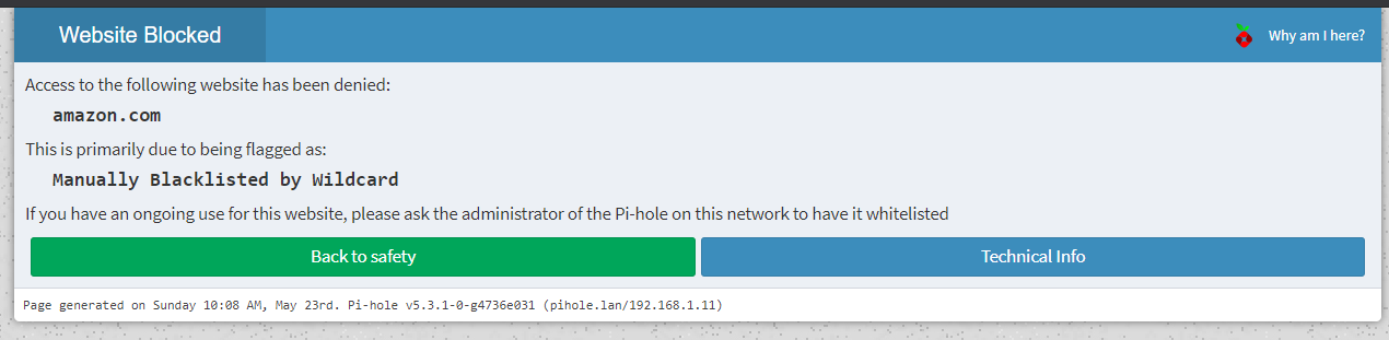

Is there a way where one could define the blocking mode for the entries in the black list to be different from the blocking mode of the FTL config?
As an example to support the statement, I started off by configuring the adlist with the different lists available online. After sometime using the PiHole, I realized some entries in the query log that are candidates of blocking and so added them to the blacklist. The thing is I was hoping to set the block mode for the entries in the blacklist to be IP, while keeping the block mode for the adlist to be NULL. My thought is stemming from the idea of what if and how a user on the network tries to access a blacklisted entry, IP would be a bit more convenient as it will display an HTML page of the PiHole if the user was entering the url in the browser url bar. I think that when the user enters the url or fqdn it is "usually" without the http/https prefix, so like just entering www.example.com (instead of http://www.example.com or https://www.example.com) and then hitting enter which the browser starts first by accessing the http port and then (in some browsers) displays the "Not Secure" indicator near the url bar. Any indicators would be ignored by the user as long as the HTML page of the PiHole gets loaded and that would be clearer for the user what exactly is going on instead of seeing the browser DNS lookup failure which could mean several reasons. This could also work out if the user enters the url with https prefix as sometimes they also ignore the safety warning and continue to the website, that would still land them on the default HTML page of the PiHole which should clarify things for the user in the same manner.

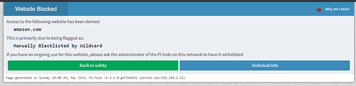

Nevertheless, if the browser would directly start using HTTPS instead of HTTP, in my opinion it would still be clearer for the user to eventually (after bypassing some ssl warnings if needed) see the pihole "blocked page" instead of some browser error that needs a higher technical understanding:
On a side note, I realized that pi-hole lighttpd needs to be re-configured to expose SSL port for the host as a start to support showing the blocked page with HTTPS.
