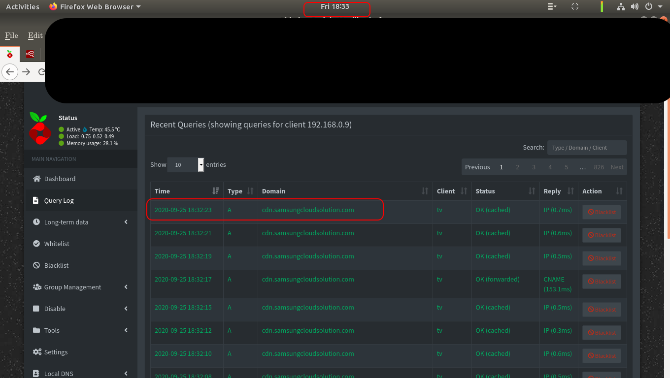

I have a Samsung TV and it is trying to call home repeatedly.
But, it should be blocked because of this:
Sorry. What am I missing?

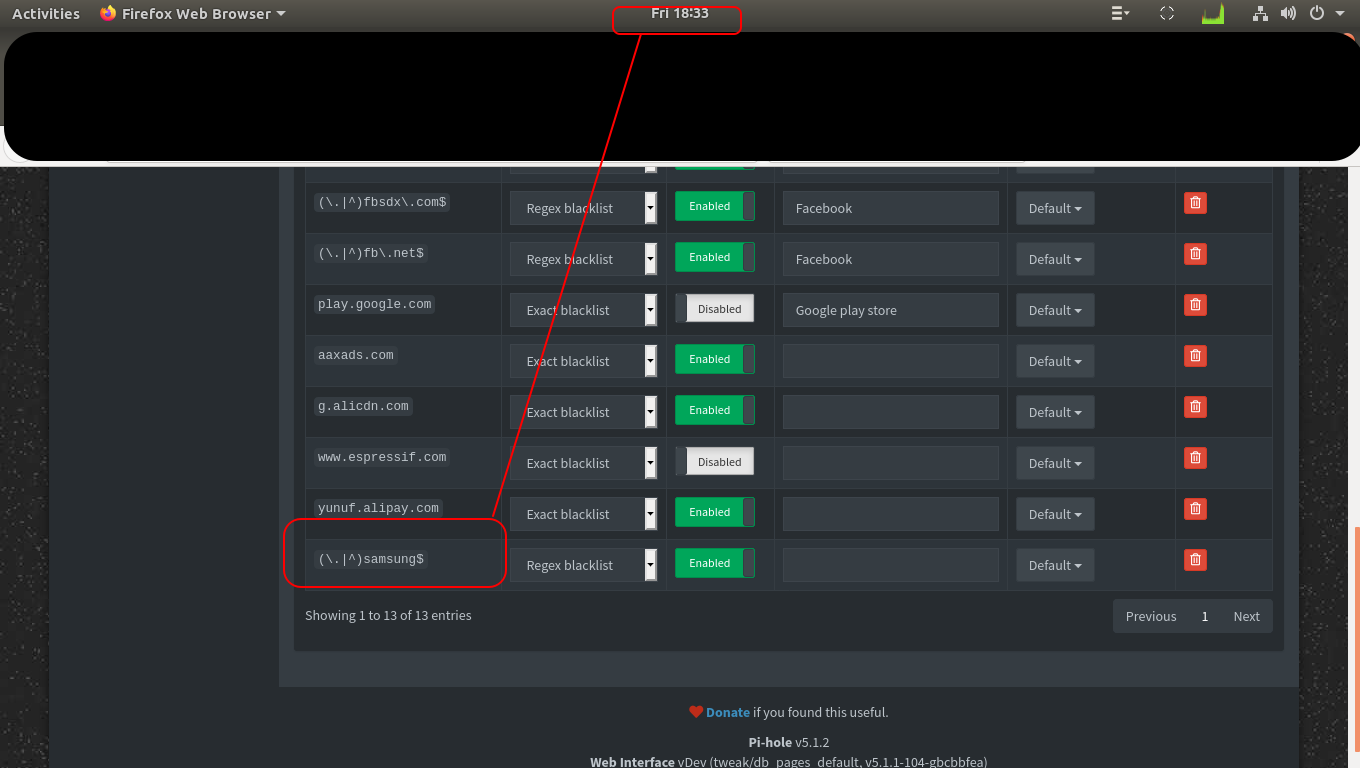

Your regex doesn't match the domain you aspire to block.
As the $
at the end defines an end-of-line match, that means your pattern requires a URL to end in samsung
. Try to replace $
with .
Have a read of Pi-hole's documentation to familiarise yourself further with regular expressions.
When in doubt, use online resources as regular expressions 101 to test your regex.
Thanks.
I guess that is a Noob mistake.
Yes, but as @Bucking_Horn said, I goofed with how I entered the name.
Now it is blocking that site.
