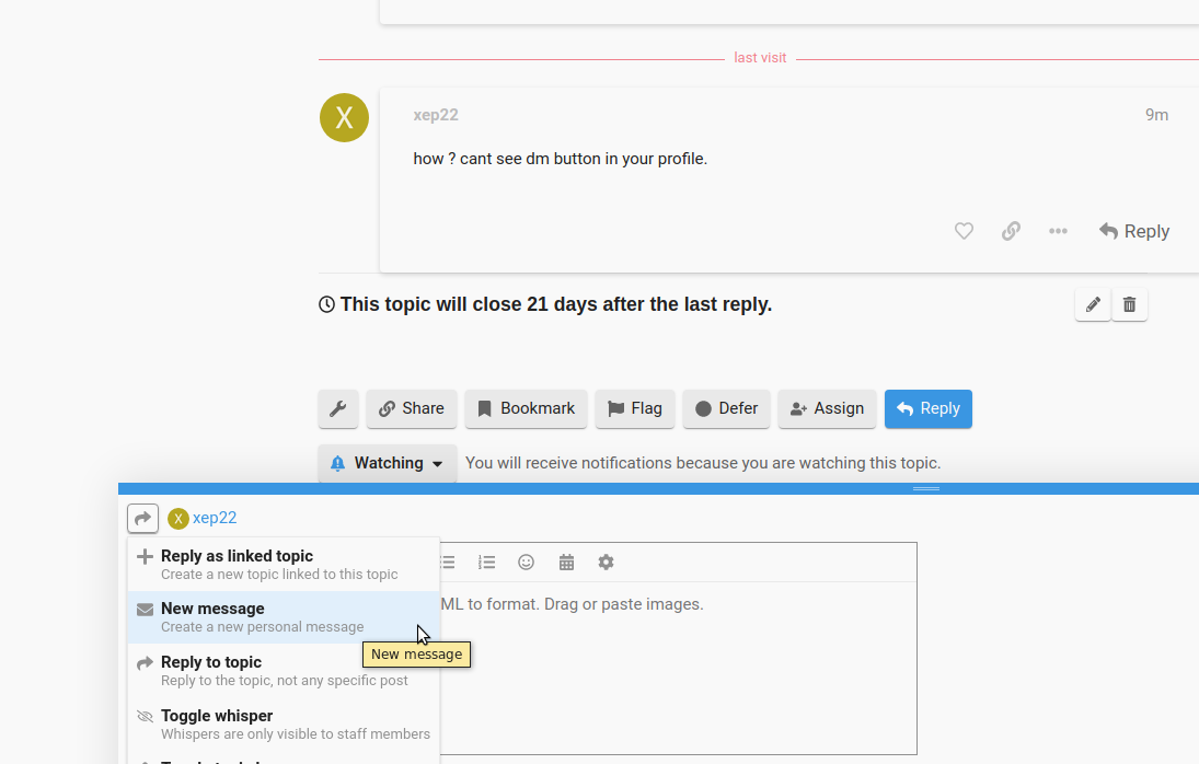

Can you DM me the log?
how ? cant see dm button in your profile.
"Sorry, you cannot send a personal message to that user."
