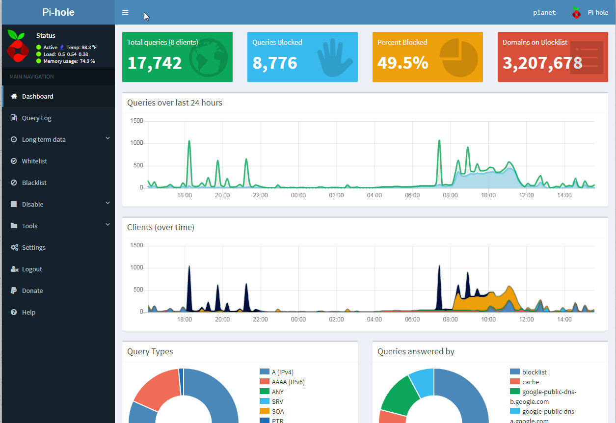

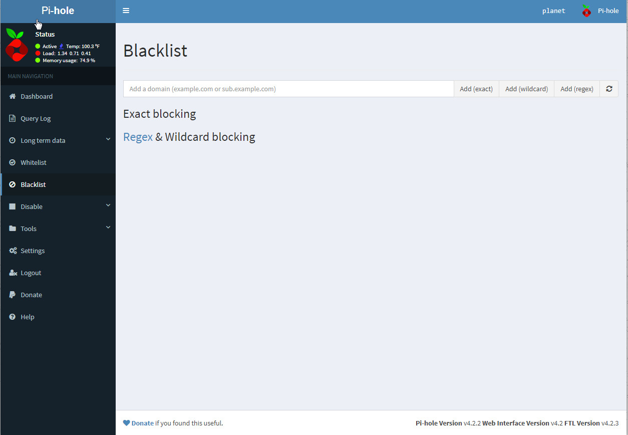

Blacklist blank after PI 3B+ crash, Dashboard shows Blocklist correctly
Blacklist should show the dozen or so Blacklists that I use. Dashboard shows 3,207,678 Domains on Blocklist
Blacklist is empty after several reboots.
[✓] Your debug token is: https://tricorder.pi-hole.net/81bzxdg97o!
This is a headless install.
PI3B+ crashed while trying to load the browser through VNC which was pointed at www.cnn.com. The Pi completely locked up. Both ssh and vnc were unable to interact with the Pi sessions in progress.
  1. Powered down the Pi and powered it back up.
  2. Now able to ssh and VNC into the PI all looks normal.
  3. Now able to access the Pi-Hole web interface.

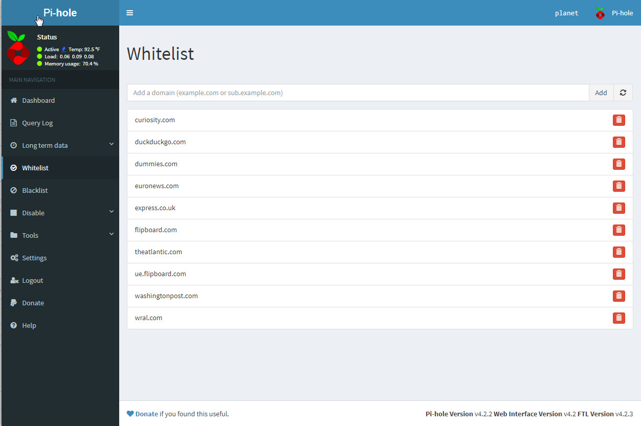

  4. The Whitelist is fully populated with the 9 web sites I use.
  5. The Blacklist is empty but the dashboard has the correct number of blocked sites...3,207,678. Refreshing the browser does not change either page.
  6. From the Pi-Hole web interface I have rebooted three times and reconnected each time with the exact same symptoms in steps 4 & 5 above.

Blacklist domains are the domains you manually entered to add to the blocklists.
Blocklists are the sources lists of domains that you add to the Pi-hole.

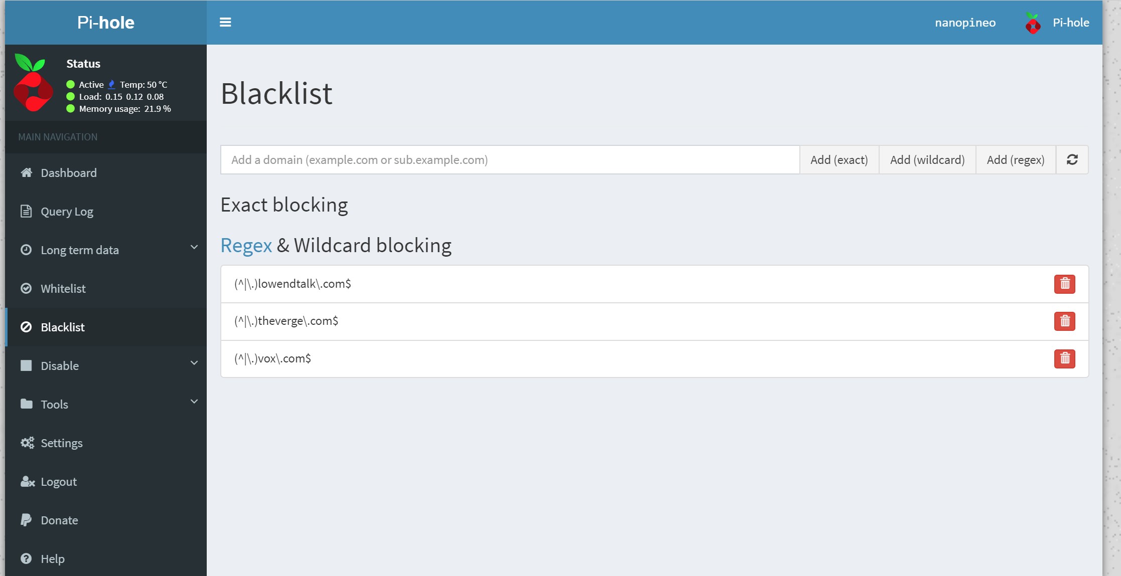

Blacklist will be empty unless you manually entered domains to be blocked individually on that page.
Blocklists (note the spelling) are the lists that are entered by URL to source.
What is the contents of /etc/pihole/black.list /etc/pihole/blacklist.txt and /etc/pihole/regex.list ? Those are the files that make up the blacklists.

Where we are not connecting is the terminology. You say that the dashboard has 3 million domains on the blocklist. Those are from the URLs that are entered. The blacklist page is something entirely different and does not show on the dashboard. Those are actual domain names, not URLs, that you specifically are adding to block.

I have attached my Whitelist. You will see ten web sites on that page.

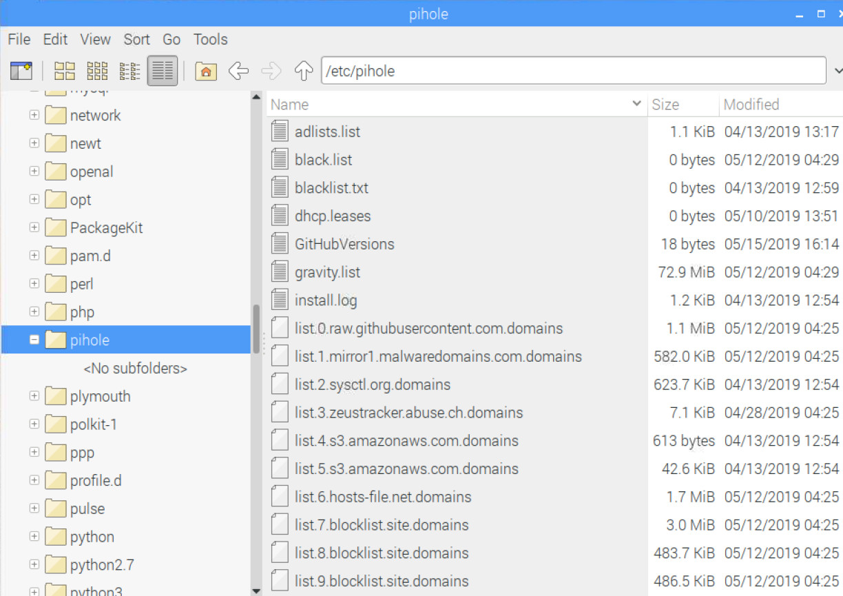

Looking in /etc/pihole, I have list.1.blocklist.site.domains through list.25.blocklist.site.domains. This image shows part of that directory.
The listing goes on to list.25.blocklist.site.domains.
Those blocklists used to be shown on the Blacklists page before the crash. Now the blacklist page is empty.
It is that blank Blacklist that bothers me. Shouldn't it appear the same and show the Blocklists (1 - 25) as it did before the crash?

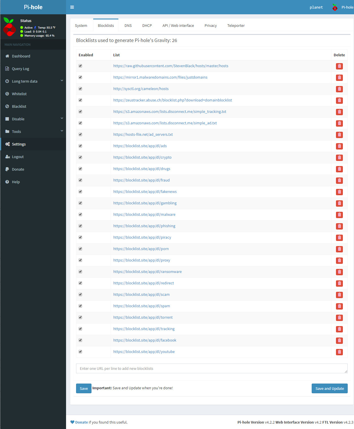

Will those Blocklists in /etc/pihole from (https://blocklist.site/app/) be updated when the system updates the blocklists? This is the Blocklist page from within the Settings/Blocklists tab on my Pi-Hole.
Again, THANKS for your patience and guidance. CraigM

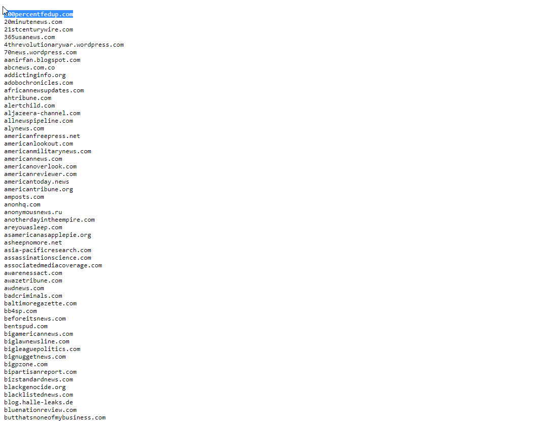

This is part of the web sites included in one of the blocklists that are shown on the Settings/Blocklists tab and is also in the \etc\pihole directory.
As you can see it is just a text file with the blocked sites urls. So I understand why these websites do not appear on the Blacklist page.

Blacklists are not blocklists and blocklists are not blacklists. They are two separate things. list.1 is a blocklist, not a blacklist. google.com is a blacklist, not a blocklist.
This is not correct. Those lists shows up on the "block lists" page, which is completely separate from the "black lists".
The list of blocklists to which you subscribe (the 25 you noted) is in /etc/pihole/adlists.list.
Your local blacklists are stored in /etc/pihole/blacklists.txt
The "domains on blocklist" that you see on your dashboard is the sum of the domains in your gravity list minus the local whitelist entries. If your gravity list (/etc/pihole/gravity.list) is empty, then you can rebuild it with the following command. Pi-Hole will go to each of the URL's in your /etc/pihole/adlists.list file and gather all the domains, remove duplicates and remove locally whitelisted items.
