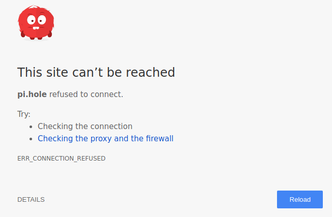

Ah, that may be the difference then. I'm directly getting this when trying to access htps://pi.hole
and it should actually be standard when you have no firewall enabled.

The following assumes that you are running Raspbian on a Rasbperry Pi (or similar) and have no firewall rules installed. If this is not true we have to negotiate how to properly set up your firewall, but that shouldn't be a big deal!
Solution for Raspbian: Check you actually have n firewall rules installed. Use sudo iptables -L --line-numbers, it should show something like
Chain INPUT (policy ACCEPT)
num target     prot opt source               destination
Chain FORWARD (policy ACCEPT)
Chain OUTPUT (policy ACCEPT)
if there is anything more, we'll most likely have to deal with that differently.
If there are no firewall rules, you can straightforwardly add the HTTPS REJECT rule like this:
iptables -A INPUT -p tcp --dport 443 -j REJECT
If you also use IPv6, add an IPv6 rule as well:
ip6tables -A INPUT -p tcp --dport 443 -j REJECT

Note that setting the values to 0.0.0.0 instead of only installing the proper firewall rules may have unintended side effects as the blocking page and maybe even the Pi-hole dashboard being not reachable any more.
