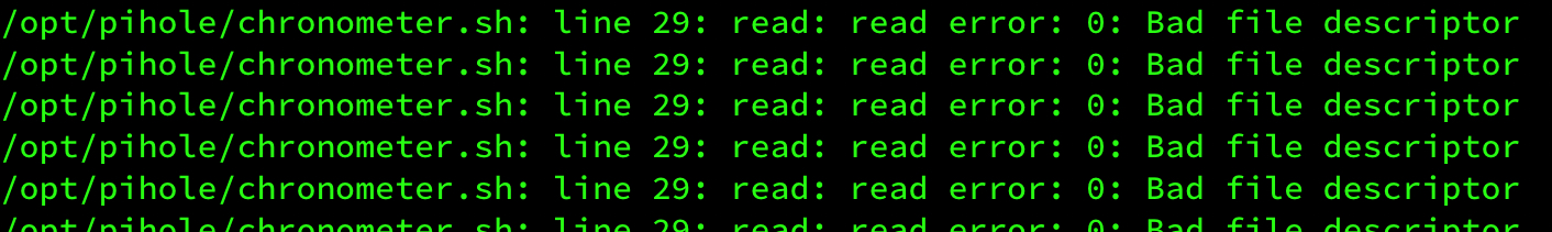

I have noticed that pihole-c gives no result in terminal anymore.
It results in an endless error message:
pihole-r (without renewing settings) does not help. Any ideas?
Thanks, Frank

oops, I changed 127.0.0.1 in etc/hosts from localhost to RaspberryPi to change the name in dashboard.
This works but was the mistake that lead to the error described. Changed it back to localhost and now chronometer works well again.
Thanks for your effort DL6ER, sorry! :roll_eyes:
Okay, no worries. I'll submit a pull request exchanging localhost by hard-coded 127.0.01 to avoid having this problem again.
