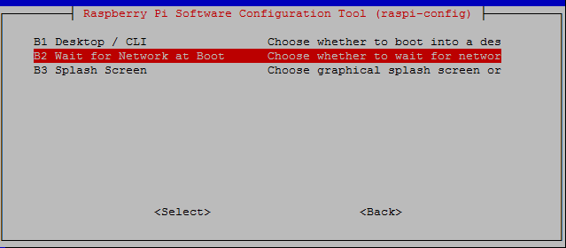

As for the sporadic mount of the network share I think that your system executes the mount command before the network is up.
You could sudo raspi-config and go to Boot Options and enable Wait for network at Boot.
Hopefully this will provide some consistency.

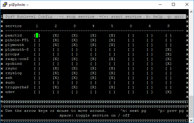

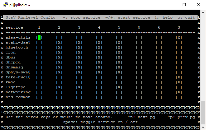

I installed the rc-conf and this is what's running right after a reboot:
The DNS Service is then down in Pihole and it's not working. When I restart dnsmasq through pihole everything works again (except logging to the NFS share).
I don't know if I run the FTLDNS. I can't recall such a question when installing pihole and left most things default. At least I know nothing works when I just booted and don't start dnsmasq through pihole (or command line).
What is a bit strange is that your command does show dnsmasq as being active, however pihole still gives the error and I need to (re)start it manually.
Regarding the automounting it's driving me crazy. I already enabled that "wait for network boot" setting so no that doesn't help unfortunately. By the way if I run sudo mount -a I don't see any running services.
