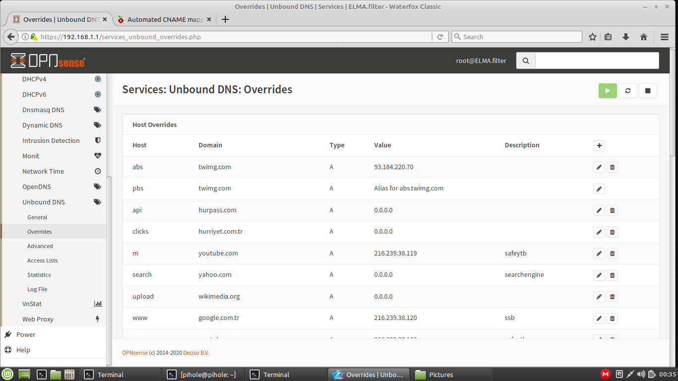

So I have made a static input for abs.twimg .com but this is not a good solution for long term. I can use this ip approx. for 5 days.

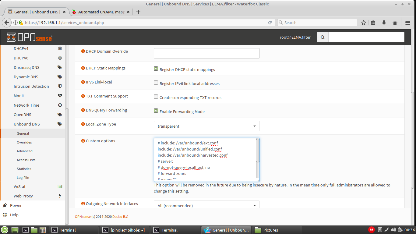

I also have an firewall (opnsense) and using DNSSEC and Hardened DNSSEC with unbound. And Unbound blocking adresses like this.
w.hurimg.com
i.milimaj.com
abs. and pbs.twimg.com
so I was overriding this adresses with unbound on opnsense.

When using "Hardened DNSSEC" option on OpnSense unbound, responses resolved from a different dns resolver than unbound server does not accepted by unbound.
If I understand correctly, your unbound setup does not respond as you would like it to respond. How does CNAME blocking in Pi-Hole relate to this problem?
Look at the manual for unbound.conf on this topic. They note that if you are behind an intrusive firewall you may need to turn off this option:
harden-dnssec-stripped: <yes or no>

Unbound can not make CNAME blocking, It sees an external resolver and block everything if I have not override with static ip. Unbound is slow resolver, when you make a change it forgets every cached record (you can also make dump backup of records but not practical)

Why are you using unbound if it does not do what you want it to do? If it is slow and won't resolve, and you are only using it as a forwarder, have you considered using a commercial upstream resolver directly?
Or, have you looked at changing the configuration of unbound so it will resolve CNAMEs?
