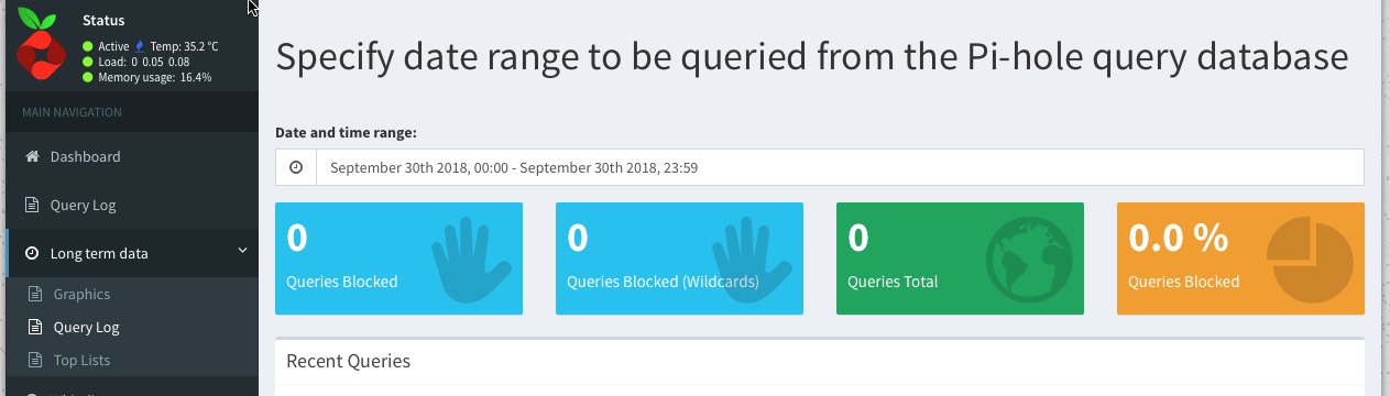

At the main menu for long term data > query log, it is normal to show zeroes until you choose a date and time range.

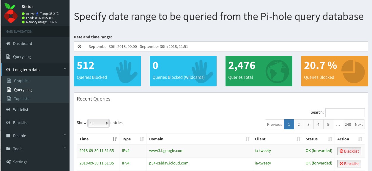

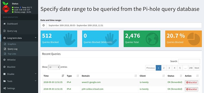

First screen at long term data > query log:

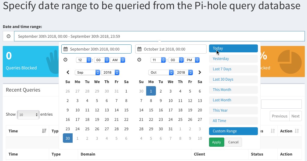

Select a date range:
Click on the date range:

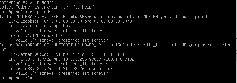

Your IP addresses are mismatched, the Pi-Hole is listening on a different IP than the Pi is assigned. IP address 10.0.0.5 for the Pi-Hole, 10.0.2.127 assigned to the ens192 interface.
[✓] IPv4 address(es) bound to the ens192 interface:
   10.0.2.127/22 does not match the IP found in /etc/pihole/setupVars.conf (https://discourse.pi-hole.net/t/use-ipv6-ula-addresses-for-pi-hole/2127)

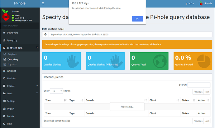

Sorry for the delayed response. I should have been specific, in the long term data it's the Query Log that has the issue where I get nothing. I just get an error.
I changed the IP on Pi-hole and I could never get the old IP address to go away
. I tried a number of things to get this changed (followed a few posts here) but I could never get that second IP to go away. This is running on an ESXi VM on my local network.
I actually want to use 10.0.0.5 for pi-hole Any guidance would be greatly appreciated.
It is possible to get errors when trying to load long term data (see the warning in yellow).
Does that error pop up immediately, or after a while?
Pops up pretty quickly a few seconds typically.
Do you have php-sqlite3 installed? Without that installed, the web interface can't interact with the database.
I just followed the instructions to install pi-hole, how can I check to confirm?
php-sqlite3 is a package, so run sudo apt-get install php-sqlite3 to install it if it's not already installed.

Ok so it looks like it's installed. Just to make sure I wasn't crazy, I edited the IP to 10.0.0.5. in `/etc/pihole/setupVars.conf' and then ran pihole -r and selected repair. did an ip addr and it still hows up as 10.0.2.127
EDIT: I'm just going to nuke this VM and do a fresh install tonight.
