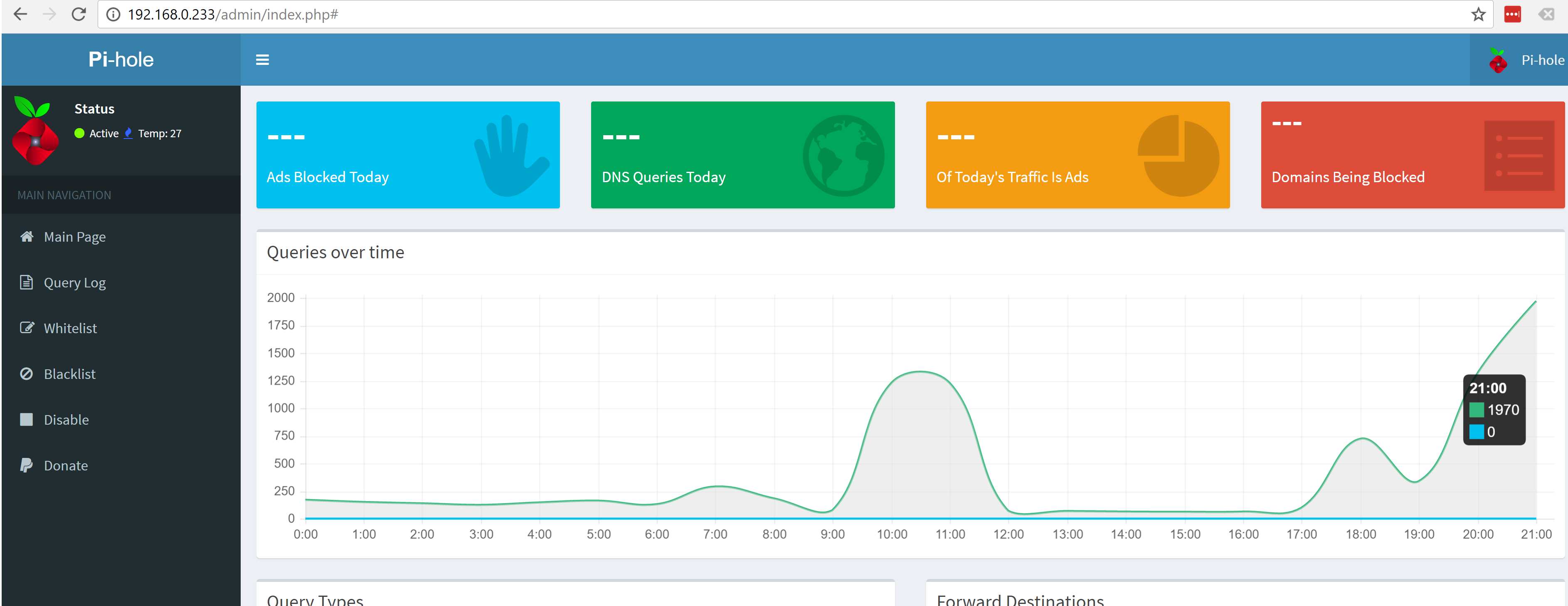

I set up a new pi-hole install last night, and I'm having an issue.
The install went fine, and I was able to set up the Pi on Debian Jessie with no issue. Pi-Hole installed fine as well.
I left it running today, and have been looking at the stats.
As you can see, I'm getting a reasonable amount of traffic through the Pi, but absolutely no ads being blocked.
I suspect I've got the DNS settings incorrect. There are two places to set the DNS.
The first is under LAN -> DHCP Server. This is just a single value for a DNS Server.
This is the setting I used yesterday to generate the statistics above.
The second is under WAN -> WAN DNS Settings. In this case you have to select the radio button to not connect to the DNS server automatically, and you can then enter a primary and secondary DNS.
I've now turned on this setting, and turned off the setting above, and will monitor that.
I've also run pihole -d. This is the output:

As you can see, there are quite a few files missing.
I'm not sure where to go from here. Any help appreciated.
