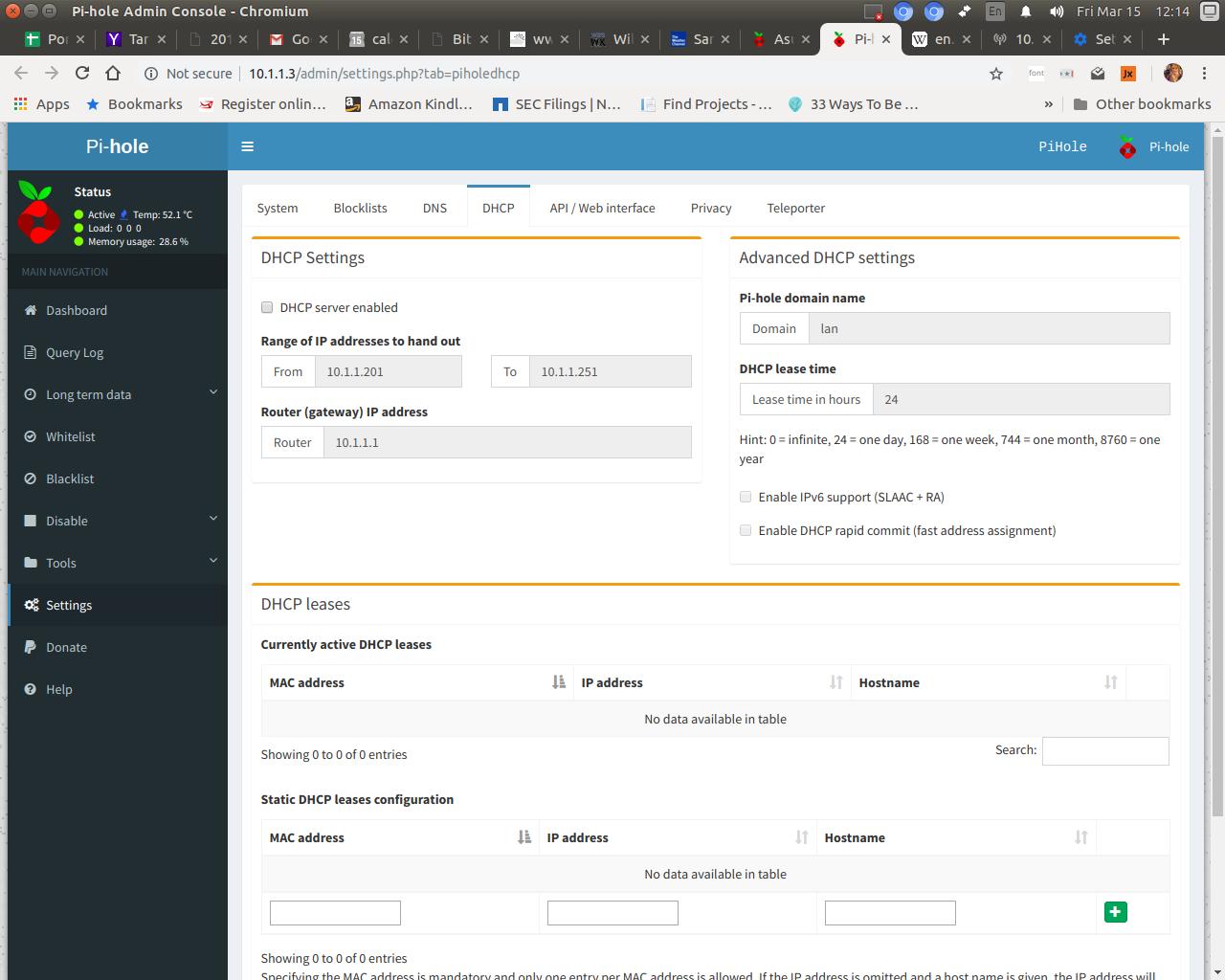

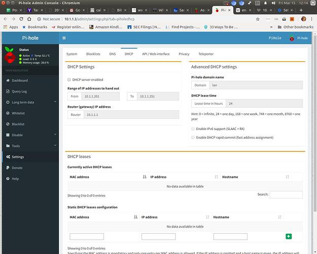

Can you post a screenshot of below dhcp settings ?
http://10.1.1.3/admin/settings.php?tab=piholedhcp
As you will see DHCP has not been enabled on the Pi as I could not access the Pi after turning off DHCP on the router as the main PC (wired and with VNC and ssh access to the Pi) was no longer connecting. So, I guess I will have to get out the screen and keyboard to start DHCP on the Pi after shutting it down on the router....or else start it on the Pi before shutting it down on the router??
The order isnt important.
You can first switch on Pi-hole's DHCP service before you disable the one on the router.
As long as when finished, only one DHCP service is active on your network when you reboot or try renew DHCP leases on the clients.
