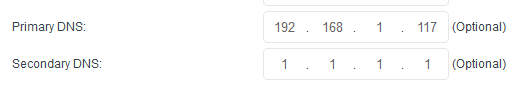

How is your router providng "secondary external DNS if Pi-hole shuts down"?
That is a very standard setting in routers
There is quite a bit of confusion regarding these terms. The router advertises primary DNS and secondary DNS, which implies they are used in strict order.
In actuality, to most clients these appear as this DNS and another DNS, and clients are free to use either at any time. Providing a DNS to clients that is not a Pi-hole leads to DNS traffic bypassing Pi-hole.
what matters is one that is available one would be used, from what I see pi-hole DNS is actually being preferred.
