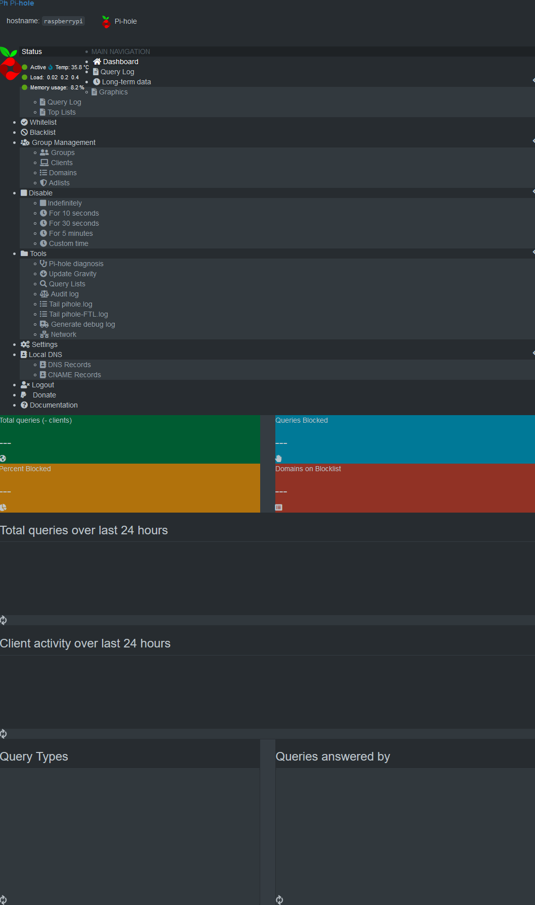

  • I applied pihole-r selecting "repair" option, pi-hole somehow started to work. But the admin page is broken.

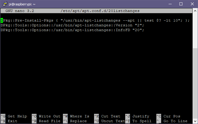

  • After searching that error code, i guessed apt-listchanges is causing problems. So i tried almost all advices written out there, but they didn't work. Here are some of my failed attempts :slightly_smiling_face:

I could not see you making any modification on
etc/apt/apt.conf.d/20listchanges
It already had the line
Pkg::Tools::Options::/usr/bin/apt-listchanges::InfoFD "20";
according to your 3rd link, so i didn't post that.
Should i add or remove anything on etc/apt/apt.conf.d/20listchanges other than these lines?
One of the links recommended to delete the file /etc/apt/apt.conf.d/20listchanges entierly and the other to remove the line
/usr/bin/apt-listchanges --apt || test $? -lt 10 from it.
You already tried to purged the package, so simply remove the file and purge it. If you never manually reviewed the changelog of APT packages on your system, you don't need apt-listchanges. Else see if a clean reinstall recovers it functional, or we'd need to run the script in verbose more to see why it fails.
But that shouldn't affect the Pi-hole web interface. Did you try to access it with a different browser or forced cache clearing (ctrl+f5)? It looks a bit like with broken cache, hence the test.
Did you try to access it with a different browser or forced cache clearing (ctrl+f5)? It looks a bid like with broken cache

Yeah, i tried most of tricks about that and they didn't solve the issue. It seems installing a clean OS and Pi-hole is the reasonable way for now.
