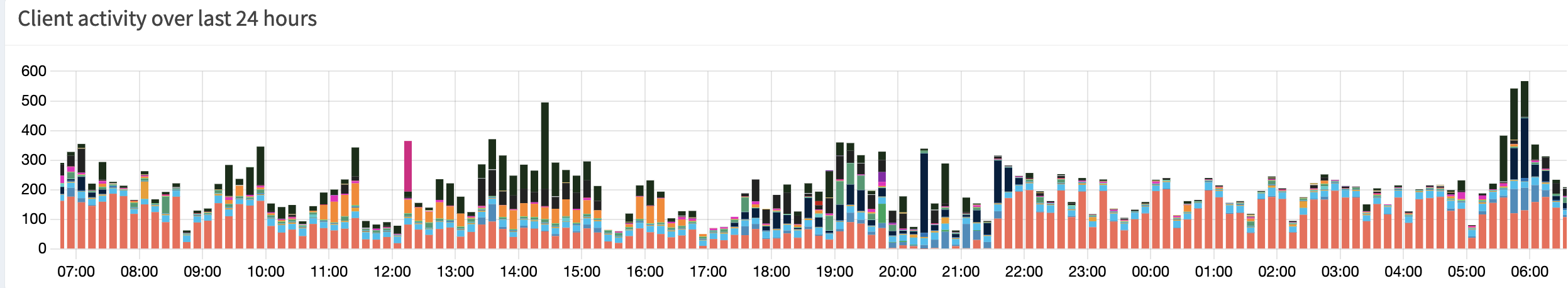

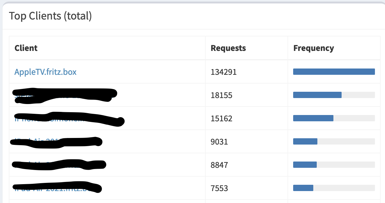

I am using pi-hole for years now and I am also using an AppleTV 4K for several years.
I haven't noticed any noteworthy amount of DNS requests from this device in all that timeframe. Until some days ago.
The device produces about 100-200 requests per ten minutes. See screenshots attached. Even more remarkable is the fact, that the device makes significantly more requests when it's in sleep mode. I used the device between 8-9.30pm (20-21.30 CET) and as you can see (it's the red part of the bars), the amount of requests in this timeframe is much lower. The rest of the day the ATV was in sleep mode.

You can click the name on the screen shown above and Pi-hole will show you the domains being requested by that client. These should help give clues as to what it's doing.
The domains being requested are alle Apple domains. About 10-12 different ones. So there's nothing special about which domains are requested, but how often they are requested.
