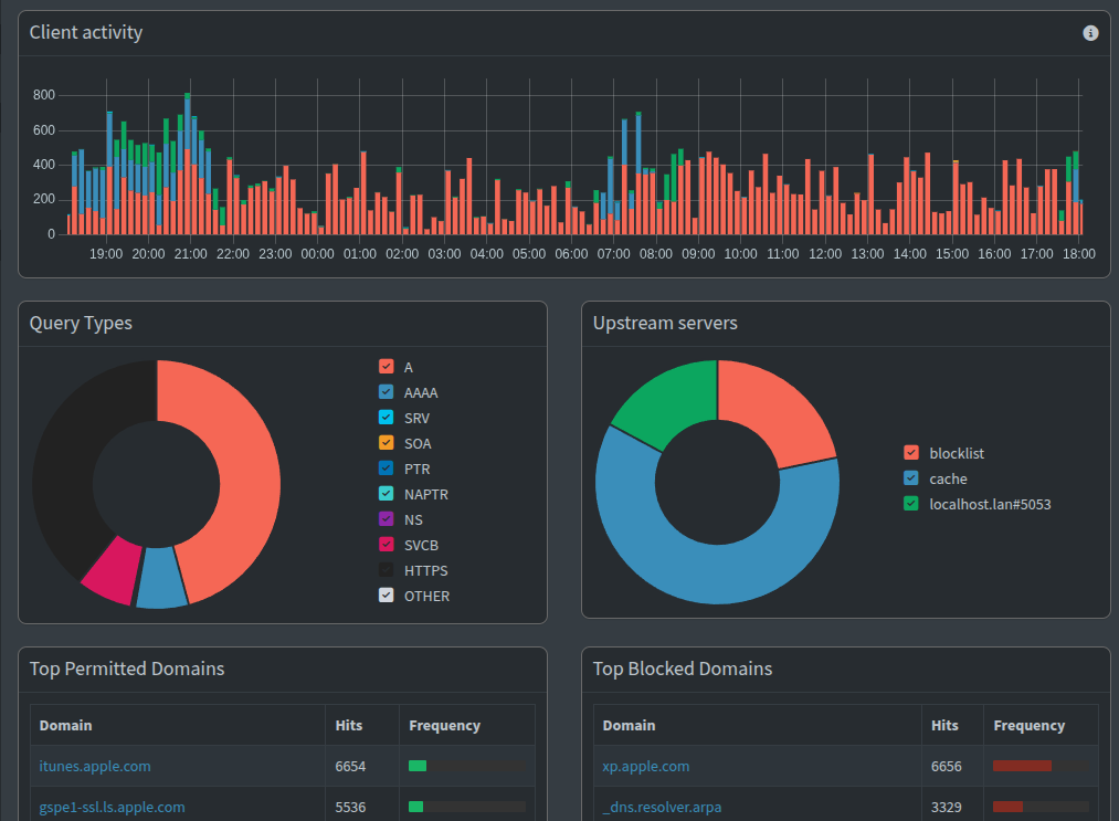

Here's a screenshot of Pi-hole's activity view:
As you can see, the following two blocked domains stick out:
xp.apple.com
_dns.resolver.arpa
I presume that those get blocked for a reason and it's better not to whitelist them. However, does anyone know what exactly causes the Apple TV to make such a massive amount of queries when it should be sleeping? Is there a solution for it?

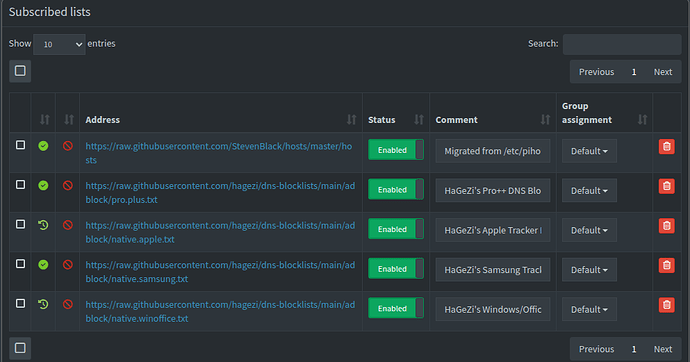

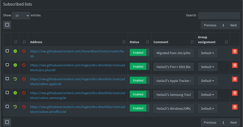

Correct. I forgot to mention which blocklists I'm using:
