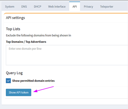

summary and SummaryRaw returns empty square brackets when including token http://pi.hole/admin/api.php?summary&auth=<mytoken>
This usually means an authorization failure.
Try this endpoint: http://pi.hole/admin/api.php?versions (it doesn't need the token)
If this endpoint is not returning Pi-hole versions, then you need to check your connectivity.
If it is returning the correct answer, your need to make sure you are using the correct authorization token.
Login, go to Settings page, API tab and click here:
