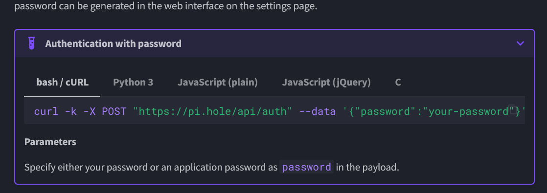

You need to pass your authentication.
that I need to pass the authentication was clear but I did not know how to combine both commands.
I found the following solution:
  • check URL and port and adjust
  • replace the password with your own one "YOUR-PASSWORD"
  • download /jq, rename it to "jq.exe" and place it into the same directly where the ".bat" file is stored --> Download jq
