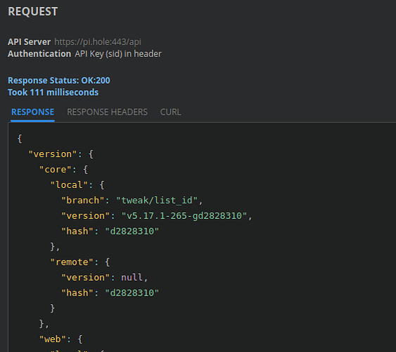

There is an inconsistency about how the remote version is sourced:
As you can see, we are getting the remove version by looking the tag of the last release - completely neglecting any possible deviating local branch.
This will never match the local version for branch != master
I don't think there is a similar "descriptive version" we could source from Github so maybe we should set local
/remote
versions to null
if branch != master
to emphasize the comparison needing to be done on a hash-basis.

The remaining bit for discussion is if we should set .local.version
to null
as well in this context (even when it is correct, it may not be very helpful)
I think it's fine to keep it for now. It gives at least some indication at which point the custom branch diverged.
Add:
And having a lot of null
in the version information makes the impression something might be wrong.
