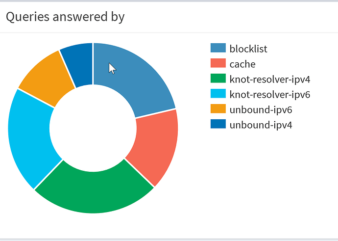

After running both unbound and knot-resolver for a week now, both with cache settings:
unbound: cache-min-ttl: 3600 - cache-max-ttl: 86400
knot-resolver: cache.min_ttl(3600) - cache.max_ttl(86400)
knot-resolver appears to be the preferred (fastest response) resolver by pihole-FTL.
knot-resolver-IPv4 25%
knot-resolver-IPv6 20.5%
unbound-IPv4 6.5%
unbound IPv6 10.7%
I'm experiencing the exact opposite which is weird, I really expected Knot to be faster. Not sure why, maybe something is wrong with my setup. Could you please post your Knot-config again?
The only thing I added to this version are the cache-ttl (knot-resolver: cache.min_ttl(3600) - cache.max_ttl(86400)) settings you suggested.
Ah ok, thanks! I removed my cache-settings from both Unbound and Knot... interesting. I think Knot needs a bit of time to predict the popular domains though...hmmm.
