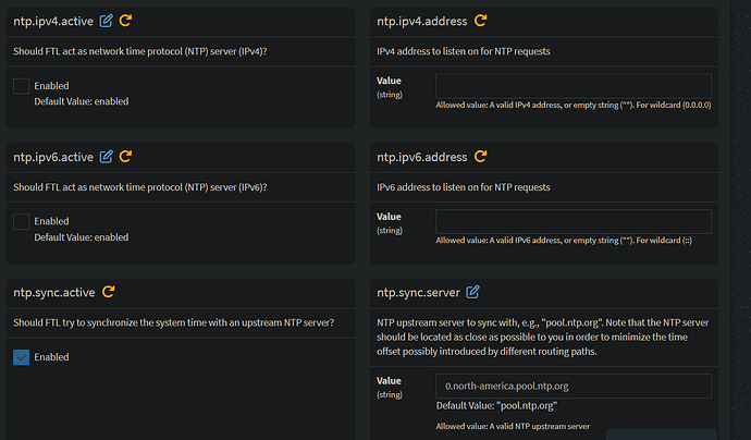

im running on a pi5 and i want to know if there is anyway to silence the NTP server errors that i get atleast once a day. since the pi5 already uses its own built in NTP server i have diabled some of the options. did i miss something? anything i can do to silene these and not loose my time syncing?

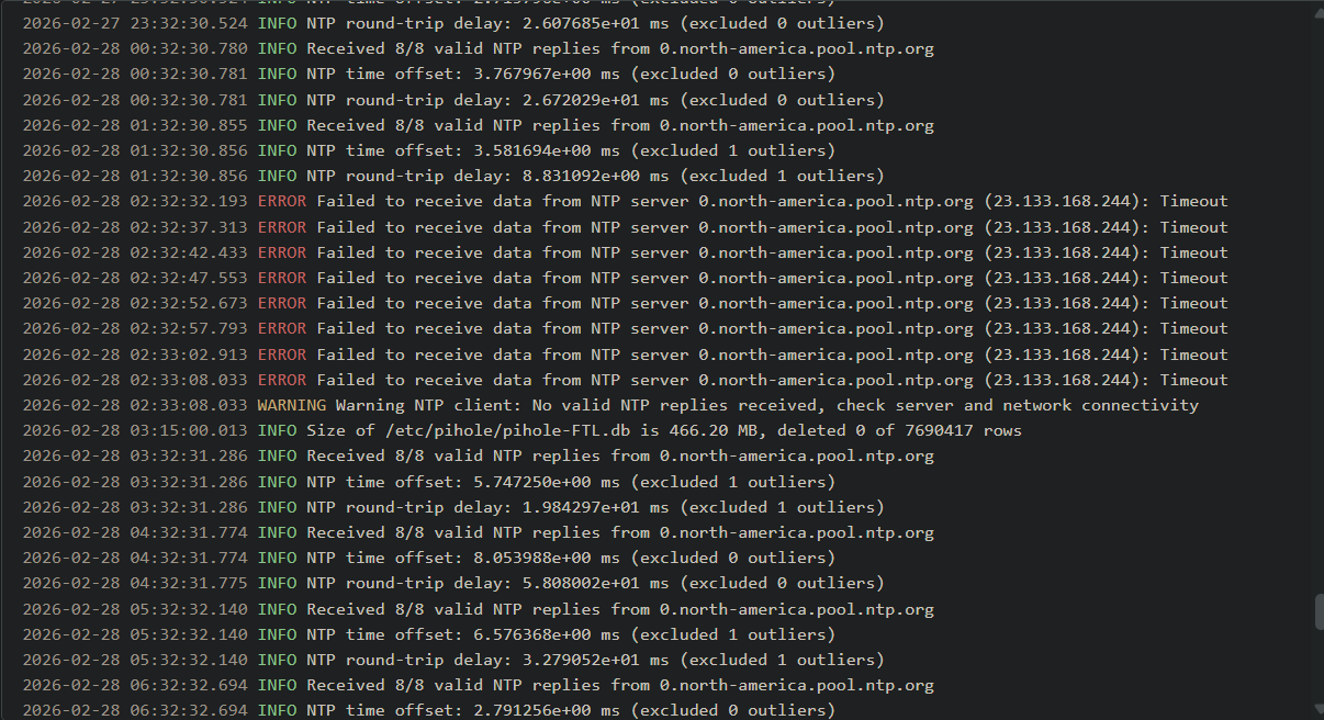

random NTP server errors:
https://tricorder.pi-hole.net/vFgwmcJ5/
You enabled ntp.sync.active and added a NTP server, but the server you chose is not responding.
You can try to change the server to a different one.
If this doesn't work, you can simply disable ntp.sync.active, since your OS already uses its own built in NTP server.

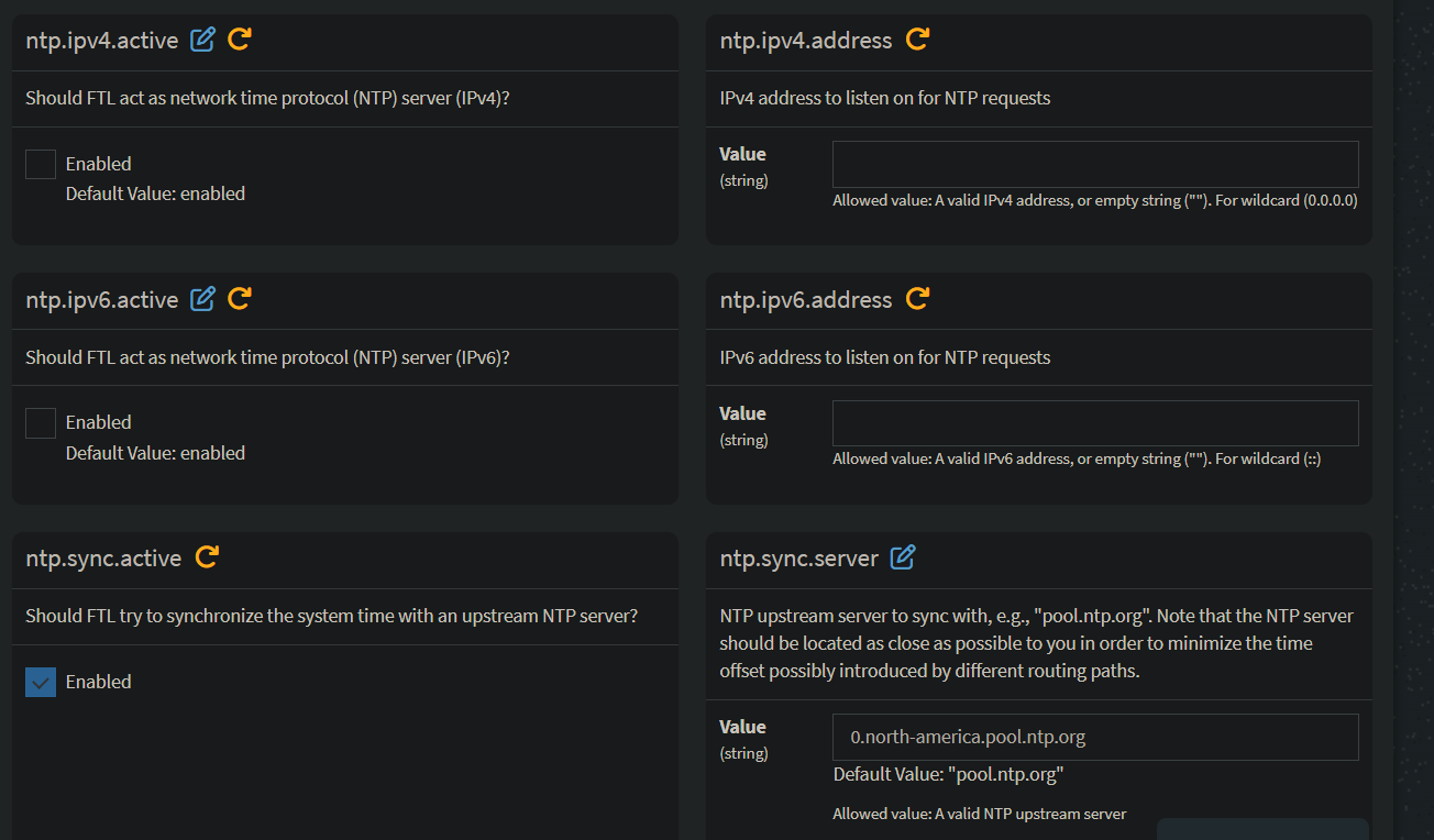

I see a [ntp.ipv4], a [ntp.ipv6], a [ntp.sync], a [ntp.sync.rtc] - but no [ntp] section. Also no setting called “ntp.sync.active”. there is the following:
[ntp.sync]
  active = true
Is this what you were referring to?
