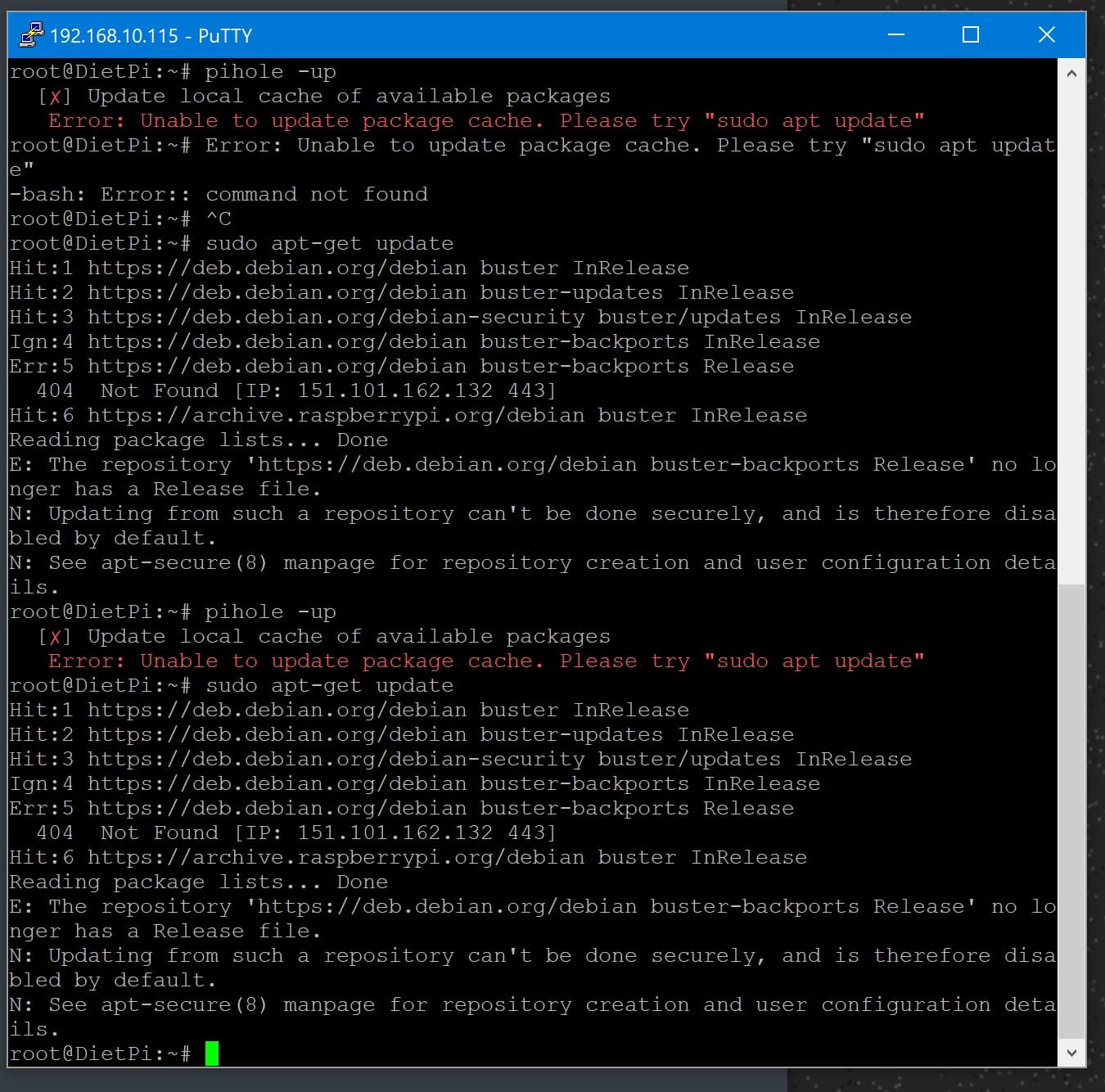

I'm trying to update pihole, currently running V5.18.2. There are several threads already here but none of those solutions worked.
Debug token is: https://tricorder.pi-hole.net/Hb0HXj9Q/ if that helps.

These are OS level errors that are preventing the apt update process from continuing. Until that process completes normally, the Pi-hole updater will not continue.
I recommend visiting the forums for your OS. For DietPi, that would include:
You might consider a clean reinstall of your OS to a later version (i.e. Bookworm). Buster is quite long in the tooth and out of Long Term Support.
If you go this route, save your Pi-hole settings via the Teleporter function and then retrieve the settings into your new install.

Debian removes the backports component from the EOL Buster suite. However, dietpi-update actually removes it for you from the list. I even pushed a new patch version to the dedicated v8/Buster compatible branch of DietPi, so that this update to v8.25.3 should be offered to you, isn't it?
