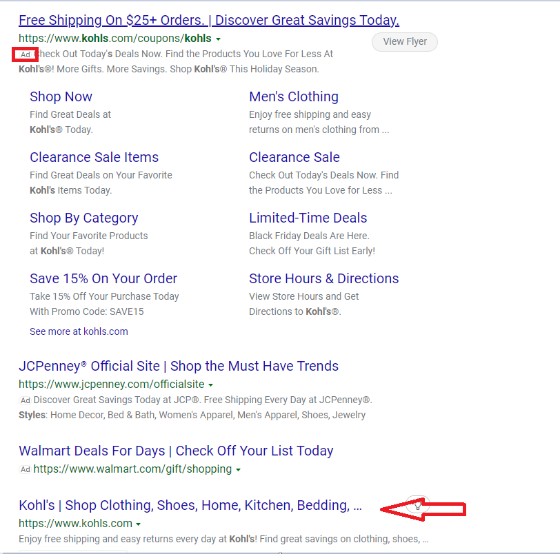

Most of the search engines are now funneling their first page of results though tracking sites, or at least the top ones. I notice that Bing will put a tiny "AD" next to it which tells me not to select it. You have to scroll down much further to get the real site, here is an example searching for Kohl's. The one with AD many times will route you though their tracking servers.

To RonV42: I am in Germany and here there are no ads for Kohls. Also, the ad links on Bing look very different, and the original URL is not in clear text as on Google. So this approach does not work with Bing, only with Google.
