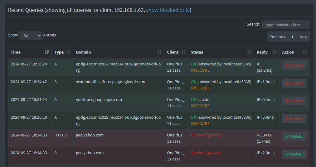

Ads are displayed and looking at the query log doesn't show that my android device has blocked any query. Testing was made starting 18:30 and screenshot was taken at around 18:50.

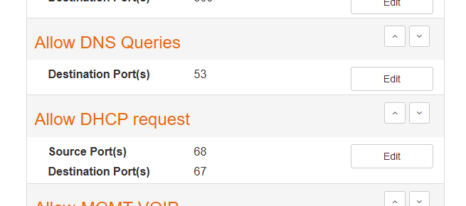

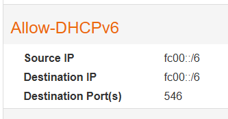

I was just digging deeper into my router settings and I just found these firewall rules enabled:
I'm going to go ahead and disable them.

Alright, some days have passed and I can actually see my phone being properly filtered. It went from not appearing in the Top Clients list to go to Top 3... but still, some apps show ads!
I'm going to try Rethink DNS to see what is going on.
EDIT:
Well, damn it. Turns out I whitelisted pagead2.googlesyndication.com because I thought that was impeding LaLigaTV (sports streaming) from working, and I wrongly assigned that rule to the default group instead to just the "SmartTV" group.
But other than that, declaring a secondary DNS for our OnePlus / Xiaomi devices DEFINITELY helped, and I'm not sure the firewall rules I disabled had anything to do with this but I will enable them again and see what happens during the coming days.
