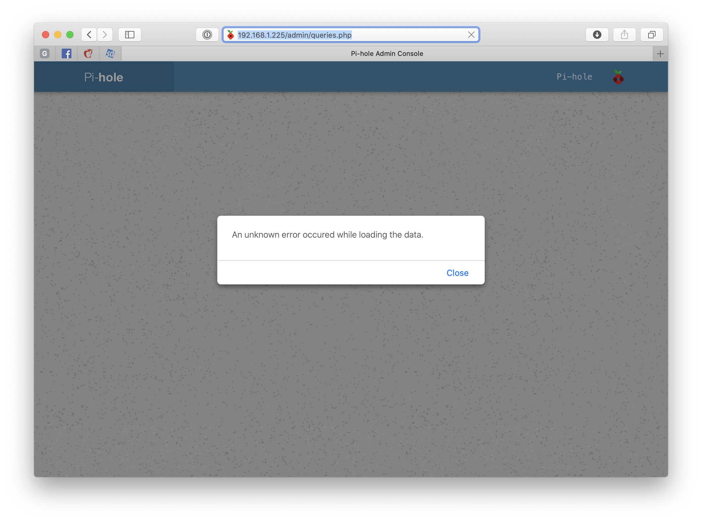

An unknown error occured while loading the data on queries.php
It should list the queries.
Error popup. See screenshot.
(also of note, the word "occured" is misspelled in the error message, the correct spelling is "occurred")

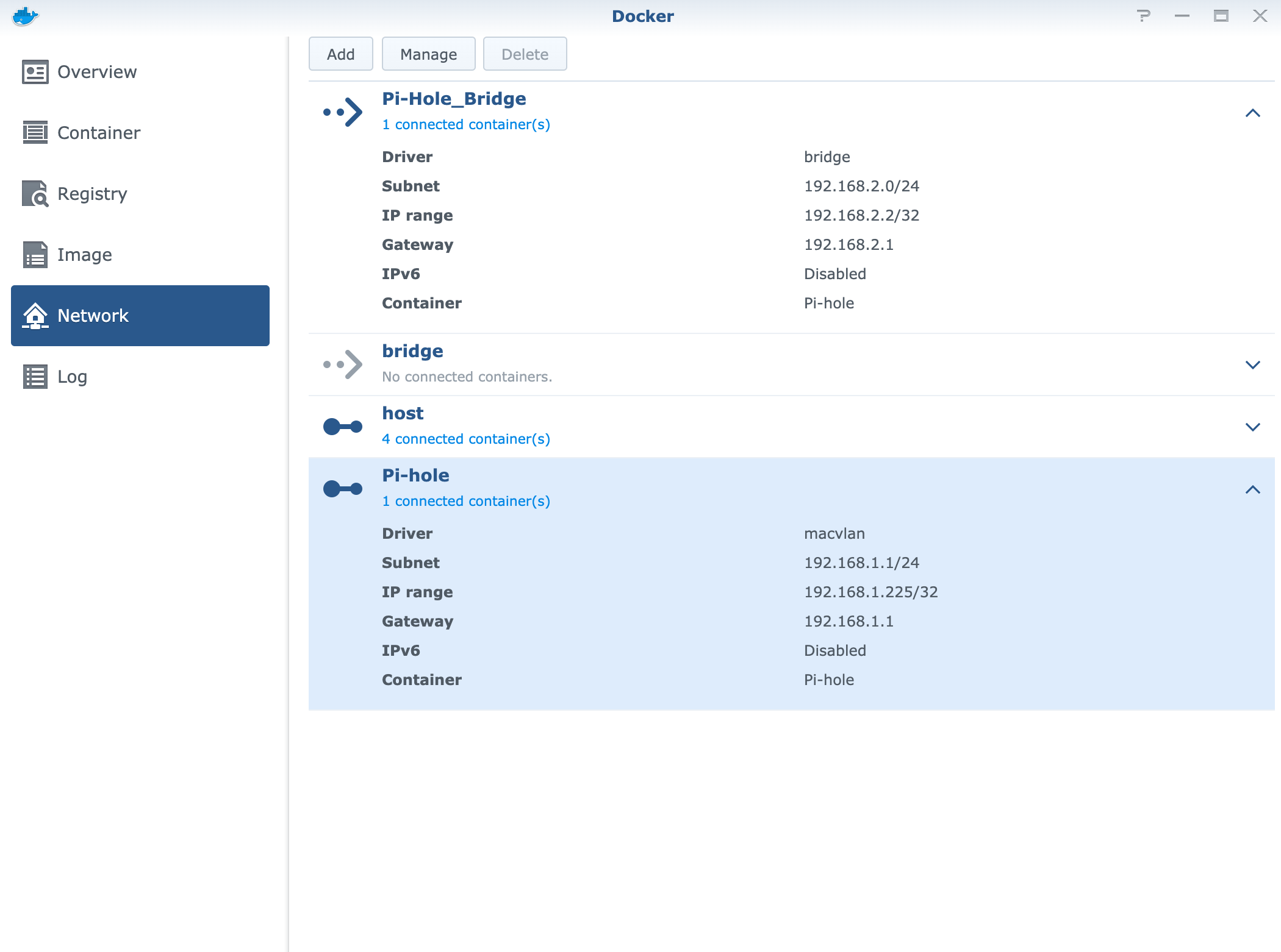

This is virtualized. Apologies for lack of those details, I wasn't sure if the debug token made that obvious.
Pi-hole running in a docker container on Synology.

I am running pi-hole, with Cloudflared upstream DNS. Nothing unusual afaik, it "sometimes" works in displaying the queries, but sometimes I get that error. This has started recently, but I just restarted the pi-hole container and it worked for a few minutes, then I get the error again. I just went back and it was working again. It appears to be intermittent, but when it doesn't work, it is instantaneous, it's not like a timeout at all, the error pops up instantly.

Everything looks okay with those config lines. What is a problem is that you have pi.hole defined in /etc/pihole/local.list as 192.168.1.225. But the IP address on the PI-hole network interface is 192.168.2.2. I think you have renumbered your network and half of the configs are set to 192.168.1.0 while others are 192.168.2.0.
It's so strange, this was working for almost a week before I started getting that error.
I have set up the networking with a Bridge so my other containers / Synology can also access Pi-hole. And I send the request to Cloudflared at 192.168.2.1#5054.
So, requests from Synology / other containers come into pi-hole on 192.168.2.2; requests from other devices on the LAN come in at 192.168.1.225.
Of note, the flag "Listen on all interfaces, permit all origins" never persists on restart. If I have to reboot pi-hole, I have to go in and re-select that each time. (not sure if that behavior is pertinent)
https://www.dropbox.com/s/sy6axl7f5jckliz/example_error.gif?dl=0
here is an example of it working just fine, then it stopping for some reason.
Just a wild ballpark guess but it's likely something to do with routing or permissions.

It may be that the web interface is trying to get the current version for the footer display and something is getting mixed in the process. @PromoFaux might have some insight on that.
What can help in the meantime is to watch /var/log/lighttpd/access.log and /var/log/lighttpd/error.log in real time when this interface issue happens. It may also be related to the memory allocation for php, the default is 128M and the query log will blow through that if there's a large history.
Lastly, if Listen All Interfaces is not sticky then /etc/dnsmasq.d/01-pihole.conf is not persisting, check the file contents before you change Listen All and then diff that with what the file reads after Listen All. If you reboot and the changes are not kept then you'll need to investigate why that file is being reset.
