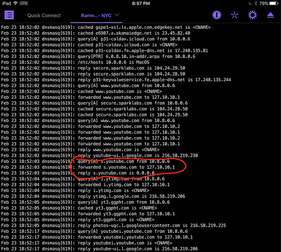

For a while now, I've been unable to get Youtube history to work while using Pi-Hole. Now before you point me here, those domains have already been whitelisted and still no dice. Any ideas?
Here's a snap from the logs:

So I did a complete reinstall of Pi-Hole and now I no longer have the issue with Youtube. I even fixed Spotify! Upon reinstallation, it didn't work, but I realized that the file for the DNScrypt servers were still being loaded by dnsmasq. Once I commented out these lines within the file, everything started to work again. All in all, the problem came back to my setup with DNScrypt.
